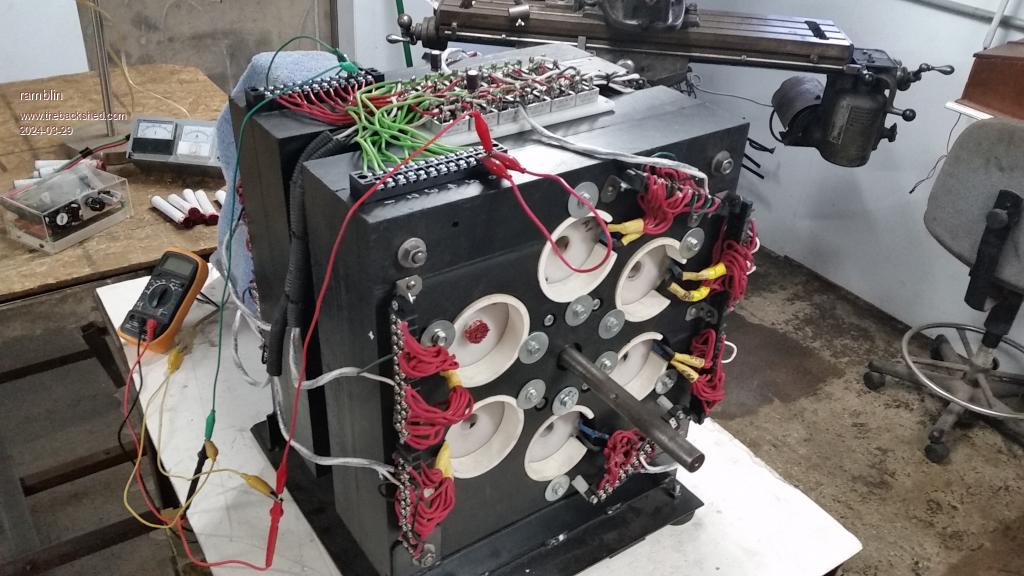

Another thing, to be clear this is never intended to be hooked to the grid. This is just a project I want to see how much useable power it can make as opposed to how much I put into it. Its a tried and true design found all over youtube. Its not cutting edge design but its a reliable design and is able to make a lot of power very efficiently. Most spin rather slow as anyone thats played with neo mags knows they can create a lot of heat. Most are not foolish enough to spin at the speeds I am.

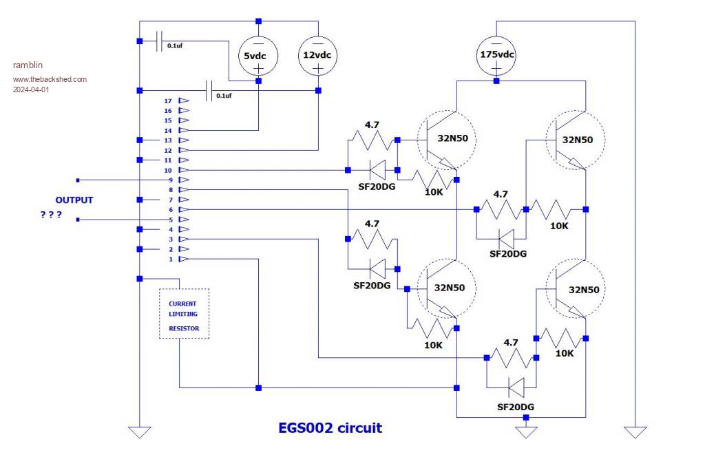

Maybe a pic will help. At least it shows I`m serious. This is the circuit I`d like to convert to work for me, but I need a little help. Works with the EGS002.
ramblin
Joined: 26/03/2024
Posts: 26
Posted: 04:05pm 30 Mar 2024
OK, I`m not getting the feedback I had hoped for so let me try so pointed questions...... Lets assume I can maintain a stable voltage and with the wiring
configuration right now, that is about 50vdc. My target would be 120vac @60hz.
#1.. Would the circuit I posted work with some modifications for some testing ? Probabley needs to handle about 15amps.
#2 .. Would this circuit need more mosfets to handle 15 amps ?
#3 .. Would 48-50vdc be optimum as I have higher voltages available ?
#4 .. Is anyone here able to give me some guidance, Maybe sketch out something for me ?

  mab1 said  Ok,
For starters, if you want 120v a.c. puresine then if you can wire your generator for 175 - 200 v instead of 50v then your egs002  can generate the desired 120v a.c. waveform directly without a transformer......... you might want a transformer for isolation anyway.............
I assume you want 15a at 120v? If you follow the above suggestion then you could manage fine with 4 IGBTs (better at high voltage than FETs probably).
Thanks mab1, So if I generate a steady 175-200vdc and use the EGS002 and this circuit this would get me in the 120vac range ? Is that correct ? If so ,I do have a 120vac isolation transformer I could use. My understanding of components is limited but would luv to try the circuit with IGBTs but have never worked with one in my life. Could you make some suggestions (sketch) on modifying this circuit. I understand how to add my own 12vdc and 5vdc but am unclear on how to ground everything and keep the board isolated .

Posted: 09:00pm 30 Mar 2024
Wow, didn't expected to see a nice generator, well done
Feedback will be little this moment of year, a lot of people have holidays now and many people are quit bussy finishing their own creations, lots of stuff in the pipeline.

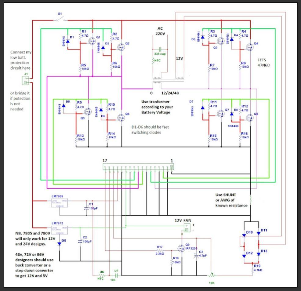

Ok, the schematic should work, but you should power your electronics from a steady powersupply. For testing you can use a small 12V battery or psu, don't use the power the generator gives at this stage.
Do you have some mosfets? IGBT's most often need a negative bias when turning off. So, I would look for at least some 100V-150V mosfets because of the fact it is difficult to get the dc voltage stable at the moment?
Will you use those 47n60 mosfets mentioned in the schematic? Those should handle 15A just fine, but they must be mounted on a heat sink, isolated with for example mica or other pads.
Maybe look for something stronger then the 1n4448 diode, it's only 200mA. Something around 1A will be more robust.
The higher the voltage the better for those mosfets from the schematic, you can test this even without an output transformer. Use an LC filter to smooth things out, look for something around 1mH and 10uF.
Or use a transformer suitable according to your output voltage. 50VDC will give you roughly 35V AC when filtered. (there is a factor 1.41 involved, if you rule out the other losses)
Running your H bridge straight from the rectified generator voltage will not work, you will need at least some capacitance, without this you will be replacing mosfets faster then you can buy. Without some capacitance the hf pwm will create very high voltages between drain and source because of the inductance involved. I would start with at least 10000uF and a small value mkp 4,7uF in parallel for 1kW. Connect your generator for at least 3 phases that way you have small ripple on the capacitors.

Well thanks for the response" nickskethisniks", this is the kind of help I need. Did a little testing last night and I do have a nice window at 175-185 vdc. @ around 550 Hz. Since" mab1" indicated I could get by with less mosfets (I thought I would need more) I copied another EGS002 circuit using only 4 fets. I left off the fan circuit for now and use my own heatsinks and fan.  Is pin 15 necessary to do some testing ? Don`t know how to hook that in. Does my AC power come from pins 5 and 9 on the EGS002 ? That many amps, I can`t have that right. Not sure how to ground everything and isolate the EGS002. I wouldn`t know what kind of current limiting resistor to use either. I`m sure some other caps need to be added.  Much here I don`t know how to do. I made a schematic of what I do know and attached a copy of the circuit I copied from.  Any help here would be much appreciated. Don`t assume I know anything.

Pin15 is the voltage feedback circuit - you need to adjust that to set the output voltage. As that circuit looks to be for 230v a.c. i would suggest dropping the value of R19 from 200k to 100k as you're aiming for 120v.
Pins 5 and 9 are connected to the two sides of the HBridge and will have the full 120v a.c. on them - this is needed for the high-side driver circuits. But the output current doesn't pass through the pins - you take that from the h-bridge FETs (shown going off to the right in the diagram).
You would have to download the datasheet for the egs002 to work out what the feedback resistor should be, but it might not be too important as you're output current is going to be limited by what your gererator can produce anyway.

That grounding point, just under the sf20dg diode should be removed otherwise you short out the current sensing resistor.
If you are running for 180VDC you won't needing 10000uF to test with, something like 1000uF will do, but keep in mind this capacitor should be rated for at least 2A ripple current depending on the output inductor.
(this is for calculation with about 8.5A, 180V bus and 1mH, 10uF )
This is a nice article for heaving some understanding:
https://www.ecicaps.com/tech-tools/technical-papers/selecting-film-bus-link-capacitors-high-performance-inverter-applications/
Try finding the eg8010 datasheet there is much more info to be found in it.
https://www.lz2gl.com/data/power-inverter-3kw/eg8010_datasheet_en.pdf
Yes pin 15 is necessary for testing, if it's not sensing output voltage it will try start by widening the pwm dutycycle and repeat this a few times before shutting down.
You can fool this pin to connect a potentiometer between the ground and 5V and connect the wiper to it. I think it want's to see 3V.
For the current this is 0.5V, people had bad expierence with the current feedback, try not to make short circuits in the first place.
To get familiar with the circuit you might want to test it first on lower voltages.

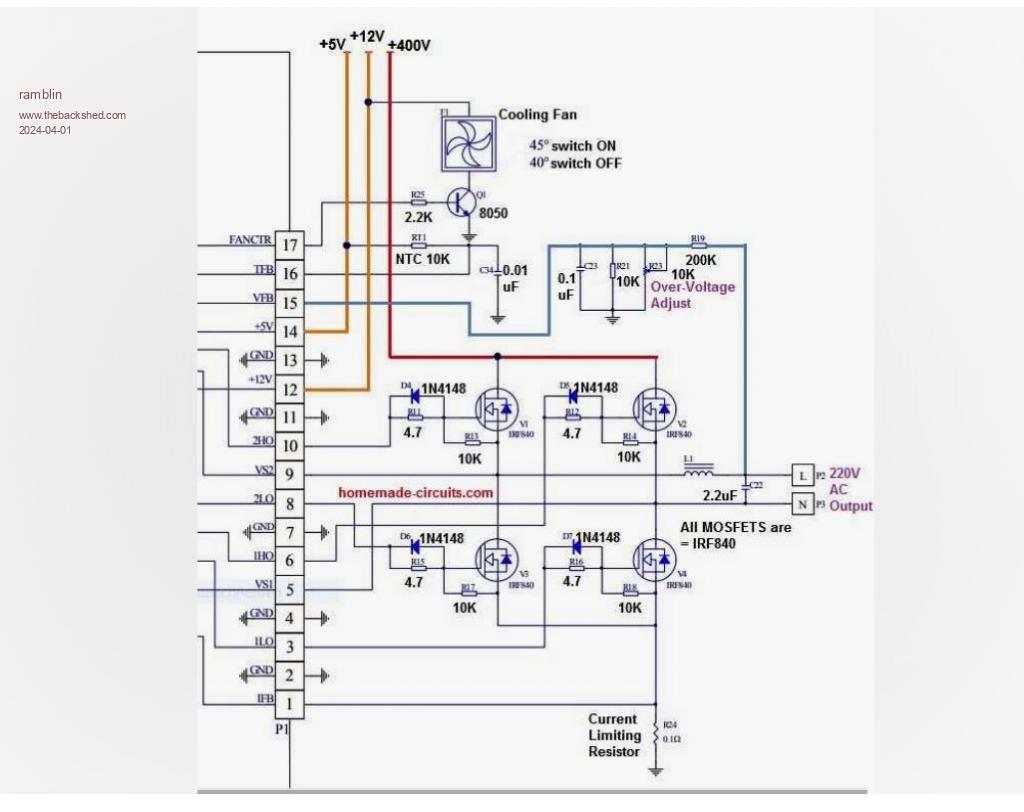

I think there might be a problem in your voltage feedback circuit. Take a look at p9 of the datasheet. Your missing a ground connection.
No the current limit resistor should be higher in your application, I would start with 0.05R-0.1R, this is good for 10A to 5A (0.01R is for 50A) wich is high enough for you at the moment, the chip will go in protection at 0.5V, make sure you use something like 1n4007 for d1-d4 to handle the voltage.
Those capacitors will work, as close to your mosfet bridge as possible, an extra small value (a few uF) capacitor parallel with low esr/esl like mkp is advisable.

  nickskethisniks said  .....No the current limit resistor should be higher in your application, I would start with 0.05R-0.1R, this is good for 10A to 5A (0.01R is for 50A) wich is high enough for you at the moment, ...
Ok, so I`ve made the suggested changes to my circuit as per page 9 of the data sheet so lets assume I got it right this time. I wasn`t aware the eg8010 data sheet was the egs002 and had the circuit everyone was coping from. I missed that 1st time around. I won`t bother posting an updated one as I have enough bad ones posted and don`t see any way of removing them. Just don`t want to junk up forum space for nothing. Now I`m still confused on the current limiting/sensing resistor and maybe someone can explain its purpose and how I would arrive at a correct value for my use.  Nick... has made some suggestions and I have "Ohmite current sense"  0.05, 0.1 and 0.01 on the way.  These are only rated at 10,  50, and 100, mOhms. and @ 5 watts. I don`t really know how to determine the amp rating or what  I need to achieve here, so a little more help would on this would be appreciated. I would seem to me the entire circuit, including the egs002 and pin 1 are expose to the high voltage/amps and only the ground is limited. Can you tell I don`t understand this part ? Thanks guys
