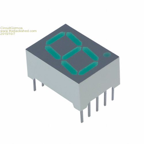

CircuitGizmos
Joined: 08/09/2011
Posts: 1421
Posted: 11:50am 07 Oct 2015
You could straddle a 7-segment LED display over a DS2408 or over a pcf8574.
