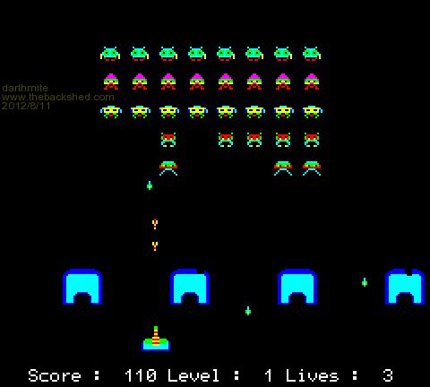

Today ... a new demo
This time i adapt 'Space Invaders' , i don't have get the one i made for
the Maximite v2.7 but made it new from start.
They are some difference between the original one and this one.
Here i can Shoot 5 bullets and the Invaders don't jump from a position to the next
one but move smooth from left to right etc ...
here a picture :
and as usual ... a video
Space Invaders for ColourMM
It's a beta actually , i have to improve some parts but it was ok for
testing.
Cheers.

Posted: 01:38pm 11 Aug 2012
As usual, good job!
Only one critisism...
The multi-fire is a bit slow. Would it be better with 1 (or 2) faster moving lasers?
Other than that, you again show the power of the new MMBasic 4.
I can't wait to get my Colour Maximite!
(Have I already mentioned this?)

Posted: 11:15pm 11 Aug 2012
Yes Nick you did it every post
A fast laser will be ok for a Arcade game like R-Type.
Here i try to 'stay' in the 'Space Invaders' concept and with 5 Shoots I'm
a little away but the original 1 shoot was a little boring

Posted: 01:31pm 12 Aug 2012
Bigmik: No, It was me making those silly noises... Bleep...Bleep...Bleep...
Darthmite: Space Invaders actually had a bit of strategy behind it if you were trying to go for high scores. It was not really meant to be a fast "shoot-em-up" style game although it did get pretty hectic in later levels when the invaders started very low... even with one laser on the screen.
The thing to note is that in the time it takes 5 lasers to travel to the top of the screen, you can probably let off about 3 faster single lasers.
Multiple shots make it into a "blast-fest" and takes away some of the finer strategy elements of the original game.
Depends on what you are going for.
All that said, it's still a mighty fine example of game programming in Maximite interpretive BASIC.

Hmmm ... yea ... True
I made some mod's on the game.
Rest 2 shoots who go faster , the invaders are faster every new levels too.
I improved the invader movement itself too that they change direction and go down when one of the 'border' invaders are at screen limit.
Here is the new source :
2012-08-14_200235_Space_Invaders.zip
And if it is too easy for you Nick ... then
Modify : MaxShoot = 2
with : MaxShoot = 1
They will be only 1 shoot at time.
Now : CanonShootSpeed = -10 is how much pixel every of the canon shoot go up
when fired , don't go over -16 of it can be that you pass some invaders
With -16 your bullet go faster ...
MaxEnnemyShoot and MaxShoot are limited to 5 , if you go for more you will get
a Sprite error because i just have create sprites for max 5 shoots for both invaders and the canon.
Now if you want made more harder you can modify :
CycleShoot = 400
with a higher value , this is how much mS you have to wait until you can
shoot again

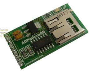

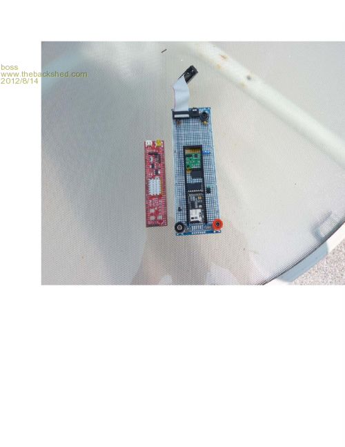

Greetings from Canada,
first I would like to thank Geoff for all the time and effort he spent with Color MM development. The result is magnificent and the decision to switch from 64 pin to 100 pin chip is smart. With additional IO pins and integrated RTC module it seems to be capable for industrial use. Because of UBW32 design doesnt have SD and RTC on board I spent lot of time time to find appropriate modules. Especially for SD card, it means the shorter connection is the more reliable the function will be. Finally I found both modules (RTC+SD) suitable to be installed under the UBW board (see picture). All modules are available on Ebay. And it works like charm.
http://www.ebay.ca/itm/DS1307-Based-Real-Time-Clock-Arduino- I2C-Tiny-Size-20x20mm-Any-uControl-/330778120169?pt=LH_Defau ltDomain_0&hash=item4d03e98fe9
Card detect signal should be connected to GND and WP the same way or you can mount WP switch on front panel.
Reagards
boss

Posted: 12:00pm 14 Aug 2012
Boss,
Is that a heatsink on the PIC32?
I really like haw everything is stored "under the house" on the proto board! Can you post a higher res photo?
- Rob.
