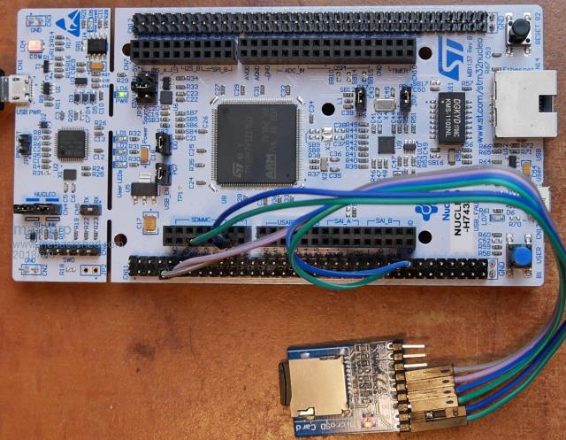

Thought I would create a new thread for the Armmite H7 as I've had a few minutes to work on it. I'll post updates to this thread as they occur and please use it for comments/bug reports etc.
This release supports the normal range of MM+/MMX file handling functions (I hope!!!)
2018-06-09_221110_STM32H743ZI_Nucleo.zip
Pinout is fixed:
SD-CS = PF6
SD-CLK = PF7
SD-MISO = PF8
SD-MOSI = PF9
These pins are not available for any other use and there is therefore no associated "OPTION" command needed.
The software automatically detects insertion and removal of a card and will deal with this appropriately. There in no requirement to connect anything to the card-detect output from the sdcard slot
Performance has also been increased significantly

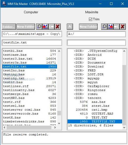

The MMEdit File Manager is happy with it.
Copy to and from the armmite works well but I have found a bug in MMEdit that cause a lockup (in MMEdit) when you try to copy the edit window contents to a file on the armmite.

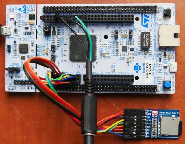

All change I'm afraid V5.04.08
2018-06-14_013523_Armmite.zip
The performance of the SD card was not good enough using the SPI inteface so I have converted the code to use the full 4-bit parallel SD card interface. I've also implemented full audio output using the on-chip DAC.
This is a major rework of the codebase as I have converted from a hack of a demo program to a full start-from-scratch CubeMX project (in other words bugs are possible/likely).
The revised pinout is as follows:
PF6, PF7, PF8, PF9: are now available for general use.
PC8: SD-D0 (pin-98)
PC9: SD-D1 (pin-99)
PC10: SD-D2 (pin-111)
PC11: SD-D3 (pin-112)
PC12: SD-CLK (pin-113)
PD2: SD-CMD (pin-116)
PG2: SD-CardDetect (pin-87)
The SD pins are dedicated and may not be used for anything else.
These pins are all available on CN8 (labelled SDMMC) in the order above from the top right of the connector down.

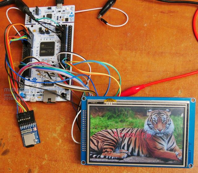

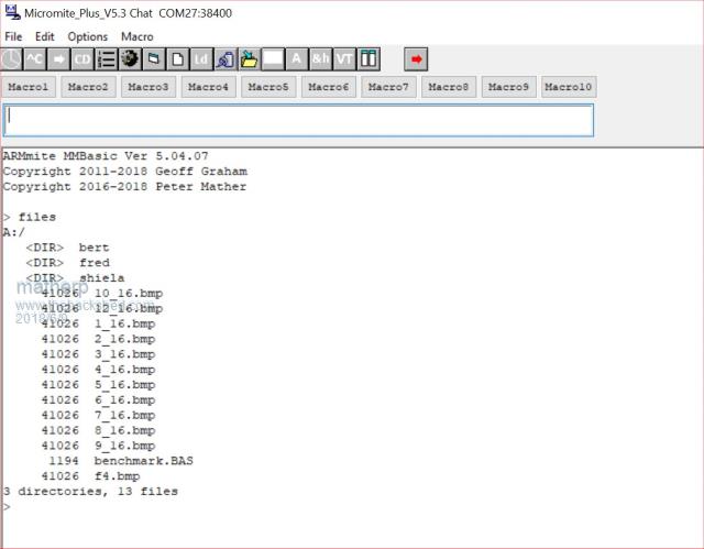

Version 5.04.09
2018-06-15_062752_Armmite.zip
I have tested this version with Jim's program above and it works fine for me but I haven't made any specific changes in that area. It is worth doing a complete chip erase when loading new versions.

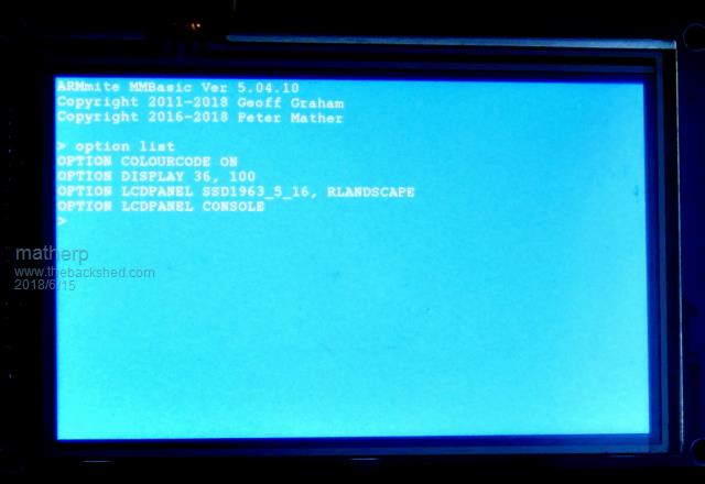

This version now supports SSD1963 displays
Valid displays are:
8-bit RGB888: SSD1963_4, SSD1963_5, SSD1963_5A, SSD1963_7, SSD1963_7A, SSD1963_8
16-bit RGB565: SSD1963_4_16, SSD1963_5_16, SSD1963_5A_16, SSD1963_7_16, SSD1963_7A_16, SSD1963_8_16
The command to initialise the display is
OPTION LCDPANEL SSD1963xxx, orientation
No other parameters are required.
You should set the display to use 1963_PWM for the backlight and then the "BACKLIGHT" command will work
Connections are:
DB0-DB15 on the display connect to PE0 to PE15 on the Nucleo (only DB0-DB7 to PE0-PE7 are needed for 8-bit modes)
SSD-WR to PG10
SSD-RS to PG11
SSD-RESET to PG12
SSD-RD to PG13 (Note this is mandatory)
Remember to connect SSD-CS to GND
NB: the firmware captures all 16 PORT-E pins irrespective of whether 8 or 16-bit communication is used. This simplifies and speeds up the code. Trying to use any of the PORT-E pins when the TFT is enabled will give the error:
  Quote  Error: Pin n is reserved on startup
The picture above is of a 5" display. Note I am having to use an external power supply for the display as the Nucleo was showing an over current warning (LD5) when powering the 5" display direct.
Performance is good. Displaying the 800x480 image takes less than 1 second. CLS in 16-bit mode takes 53mSec.
All displays support transparent text and BLIT. GUI commands appear to work but aren't tested, however as touch is not yet implemented they are of little use. "SAVE IMAGE filename$" works as expected and saves the screen contents as a .BMP file

just somes questions:
1 - with this version, mmbasic say that is "v5.04.10"
2 - I have a 5" LCD, but with sd card. I have seen that you disable spi5-sdcard and use 4bits-sd. Can i use spi1 (arduino D10/D13) for my SdCard on lcd?
3 - maybe it's too early, I need to use COM1 and COM2. on what pin this signals will be connected?, and is it possible to have interrupt functions (the best is to have rec and emit interruptions calls (not only rec as in pic-mmbasic)
Edited by goc30 2018-06-16
Posts: 12185
Posted: 07:33am 15 Jun 2018
  Quote  1 - with this version, mmbasic say that is "v5.04.10"
Yes I updated it when I included the console functionality
  Quote  2 - I have a 5" LCD, but with sd card. I have seen that you disable spi5-sdcard and use 4bits-sd. Can i use spi1 (arduino D10/D13) for my SdCard on lcd?
No - sorry. Testing showed the SPI driver was too slow to be usable for things like picture load and sound
  Quote  3 - maybe it's too early, I need to use COM1 and COM2. on what pin this signals will be connected?, and is it possible to have interrupt functions (the best is to have rec and emit interruptions calls (not only rec as in pic-mmbasic)
Can't be certain on pins yet but com ports should be fairly soon. pic-mmbasic does use interrupts for both TX and RX for coms except com2 on MM2 which is bitbanged. Armmite will use interrupts for all coms. Console already uses interrupts for TX and RX.
I am looking at a PCB design that will interface the Nucleo to a SSD1963 screen and has a SD card on it. Suggestions for other facilities welcome.
