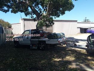

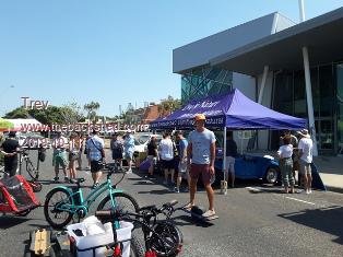

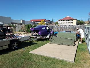

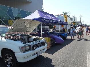

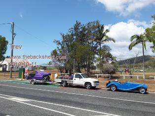

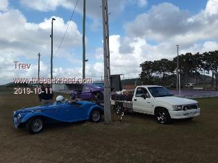

We have done quite a number of Electric Vehicle shows over the years. Not long ago I posted several of those trips in the EV 7 thread starting part way down on page 2 and going into page 3. A few weeks ago, we went to Yeppoon Sustainability Expo. Glen George came along for a test run in preparing for the big drive to Sydney, AEVA Electric Vehicle Expo. Glen is the owner and driver of the first Electric Vehicle around Australia. Check out Glen's websites http://co2race.net/ https://www.facebook.com/The-Great-CO2-Race-205319656190698/ Here is some pictures of the Yeppoon trip and show............. Left Mackay early in the morning. Charging at Sarina and Carmilla Dumping power from T-Rev to MGEV at Waverly Creek and charging at Marlborough Camped at Yaamba. Next morning dumped power from T-Rev to MGEV Drove to Yeppoon. Booked into a caravan park and got MGEV plugged in. Glen and I went driving in search of bigger power. Found the local showgrounds (thanks Dale for the location) and negotiated a charge with the caretaker. After charging EV Hilux and T-Rev, went back to the caravan park. Next day was the Sustainability expo. Quite a big turn-out for the first of such events for Yeppoon. Edited 2019-10-11 18:34 by Trev Trev @ drivebynature.com |

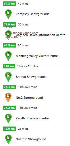

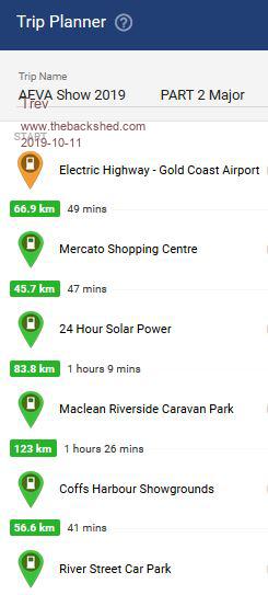

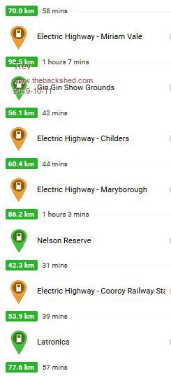

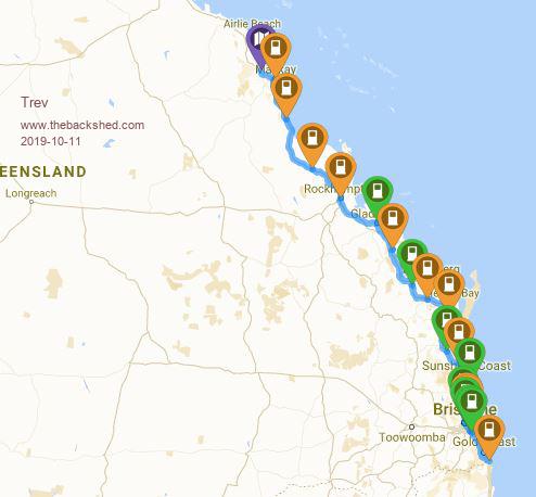

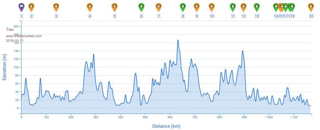

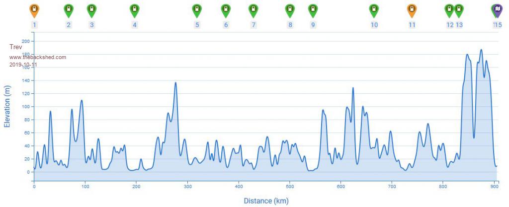

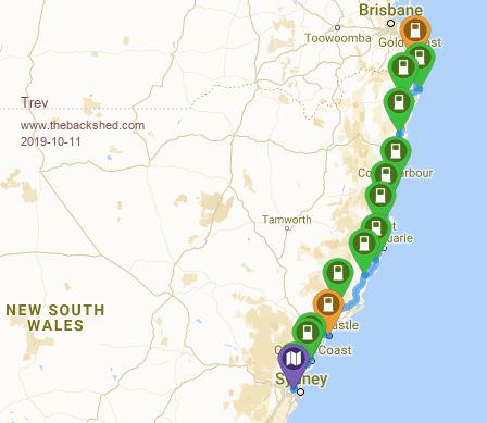

So the big drive will start next week. AEVA EV Expo in Sydney. http://www.theevexpo.com/ We have planned, and re-planned and checked over the plan and edited a few times. That's not to say we have planned or are prepared. Driving electric is still in its infancy and the charge points vary in distance apart, vary with different plugs, and sometimes don't work! Plans do change. You can find all the charge points on https://www.plugshare.com/ . and do all your trip planning in this website too! Here is the map of our planned charging stations. There is a lot more charge sessions for MGEV, than shown on the map. MGEV only has a 70-80km max range now. The charge stations are not that close, hence the reason for dumping power from T-Rev to MGEV. The plan is divided into 2 sections, so the tablet (for traveling) can handle the amount of data. Kuttabul / Mackay to Gold Coast Gold Coast to sydney Here is the list of charge points And another piece of valuable information is the Elevation Charts. If you are going uphill, it does take more power. A head wind also uses more power, but that has to be played on the day. Pulling the trailer with T-Rev (1100kg) also takes a lot more power. Kuttabul to Gold coast Gold Coast to Sydney Edited 2019-10-11 20:07 by Trev Trev @ drivebynature.com |

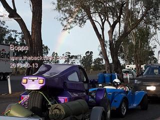

Yeh Boppa, I guess I drive past lots of people. The EV Hilux range is currently 100km on the Hilux battery pack while towing T-Rev. Earlier this year I removed 4 cells, from 52 cells back to 48 cells. This is so I also can dump power from T-Rev to EV Hilux when I need to. With no power from T-Rev to MGEV, using T-Rev in EV Hilux, I figure I could do about 200km. I have done 170km with some spare power. Davo99, charge time depends on how we charge and how much power we need to put back in. It will be longer charge time with 3 vehicles to charge up. Most charge times, I will be using EV Hilux and T-Rev chargers to power up MGEV as well, as most charge stations only have 2 outlets. EV Hilux and T-Rev have higher charge rates than MGEV, so will dump to MGEV while charging EV Hilux and T-Rev. I will try to answer this question in terms of specific time along the journey. This is a test to see how the pictures might turn out. Uploading from the tablet. The picture is of a rainbow at Yaamba on the way home from Yeppoon. Trev @ drivebynature.com |

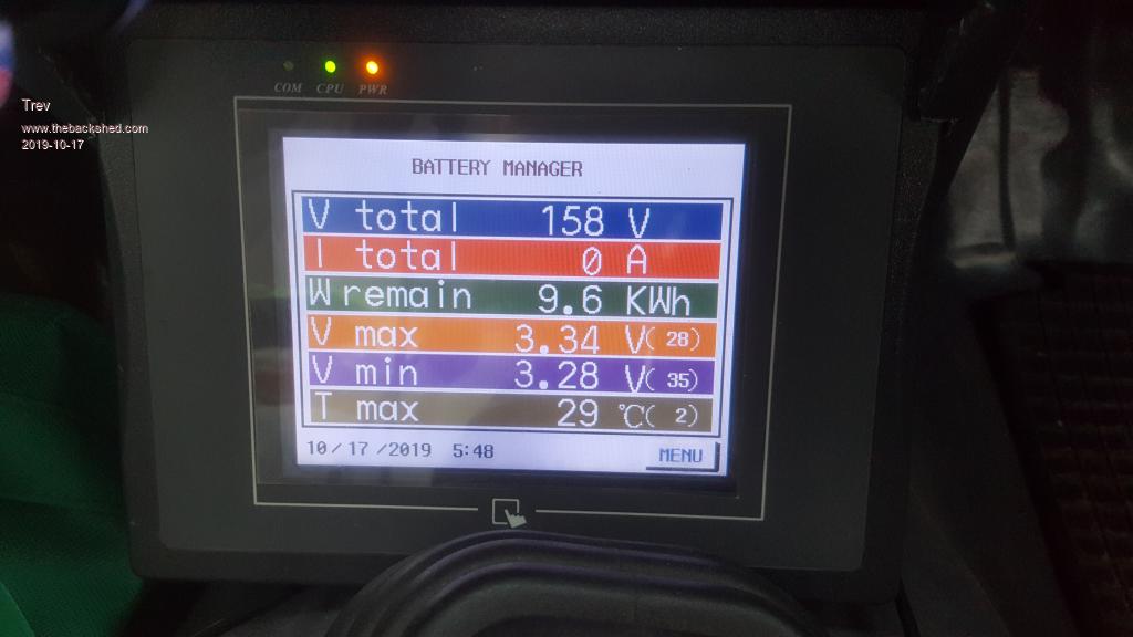

I left home, Kuttabul Qld, at 4.38am. Met up with Glen George at Mackay at 5.30am. Drive to Sarina. Forgot to photo the speedo reading at home. In Sarina trip meter which zero at home, shows 76.2km and main reading shows 92700.1km. So speedo reading at home would have been 92623.9km Dumping power from T-Rev to MGEV 9.15am. After MGEV, I will connect it up to dump to EV Hilux. EV Hilux used 18.6kW to drive the 76.2km. That's 4.1km /kW x 26kW = 106km range. Trev @ drivebynature.com |

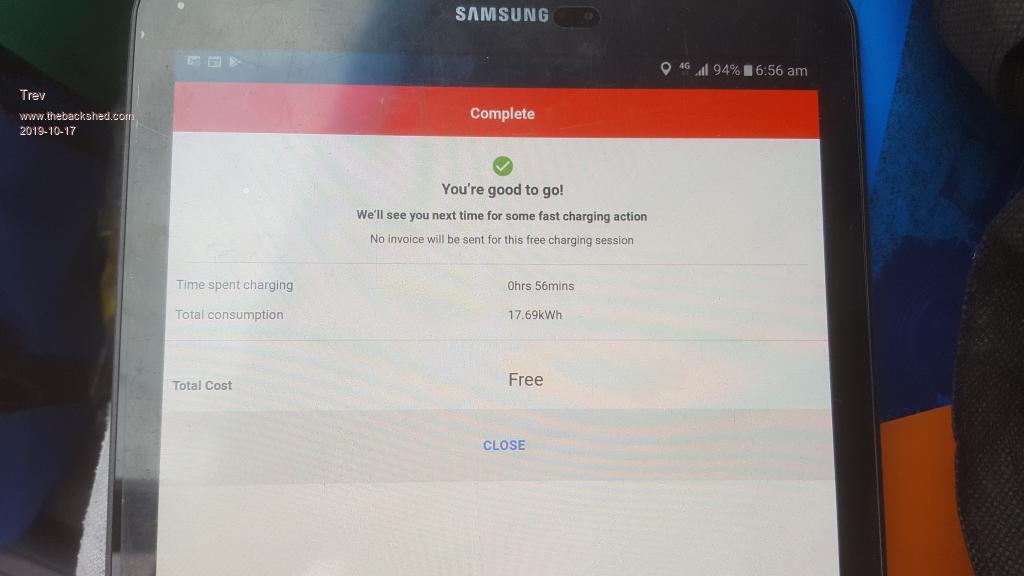

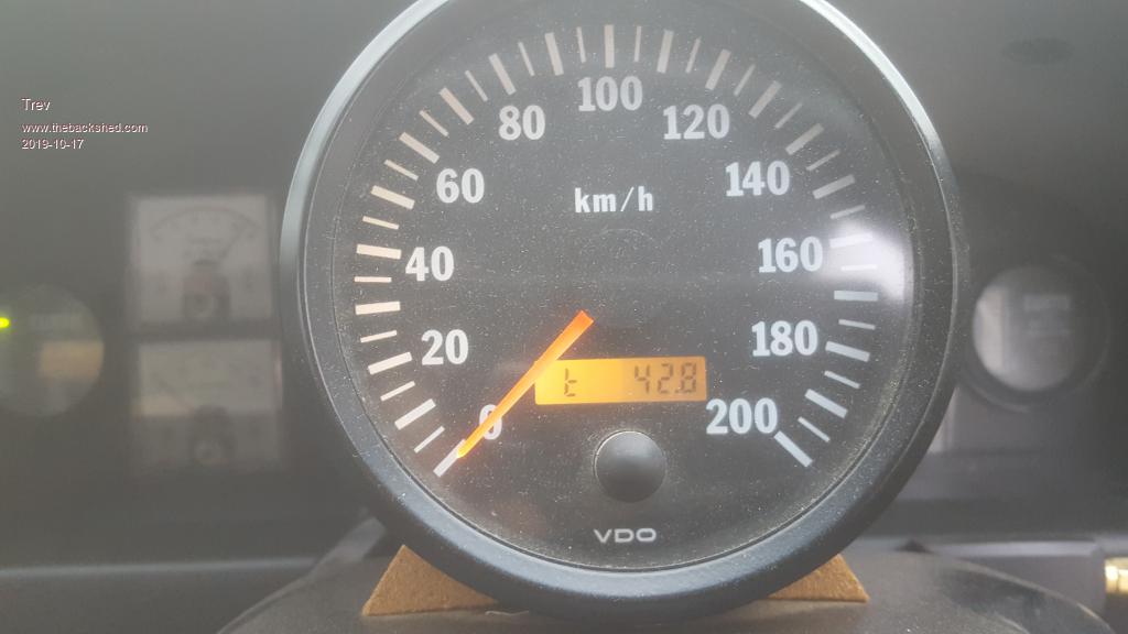

3 vehicles, home, Kuttabul to Mackay, 42.8km, EV Hilux used 9.6kW recorded on its monitor. Chargefox app recorded 56 minutes 17.69kW. Trev @ drivebynature.com |
