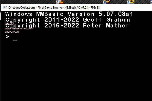

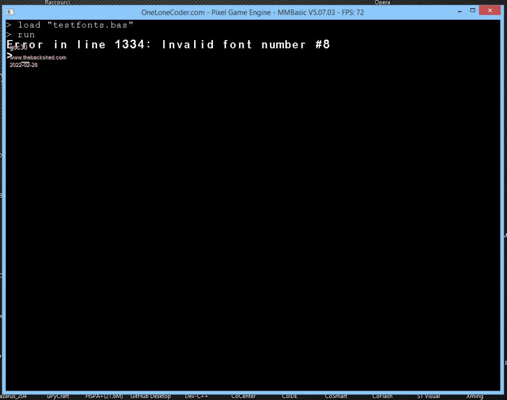

Hi Pete with beta, mode -16 is ok. But I have in "mode 16" the same problem: after init screen, cursor is out of window. In fact position 0,0 is in screen border, not in visible screen, you don't add heigt of top screen border pb with win10 is probably pb of audio driver. In this pc, I use fiber output to audio external box Wish : is it possible to load more than 5 fonts. As others MM, 16 fonts are the best thanks |
matherp Guru Joined: 11/12/2012 Location: United KingdomPosts: 8592 |
I assume you are running on a 1080p monitor. Mode 16 works perfectly on a 4K monitor. You can't get 1920x1080 on a 1080p monitor unless in fullscreen. I've made the border the minimum possible allowed in windows. is it possible to load more than 5 fonts. As others MM, 16 fonts are the best The font handling should be the same as other MM - looks like a bug |

I use 2 screens in 1920x1080 each. Problem is not here, problem is just that in "mode 16" I have no cursor it is no visible because it is out of border window Here my test fonts program testfonts.zip |
The font issue was a bug - your test now works perfectly on my development version - will post tomorrow. The cursor issue is something to do with your set-up. I can't replicate on either a 4K monitor or a single 1080p monitor. Do you have an issue if you use mode 15? |

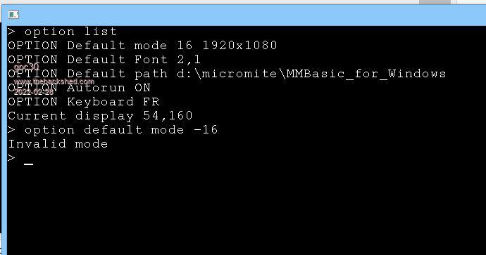

bug is in this part for i=1 to nbfonts 'if nbfonts > 7 then it bug font i,1 vsize(i,1)=MM.info(fontwidth) 'dim vsize(16,3) as integer vsize(i,2)=MM.info(fontheight) next i mode -16 is the best for me. I don't want to use "mode 16", but my pb is that option default mode -16 don't work (in v03a12 it work without pb) Edited 2022-02-28 09:11 by goc30 |

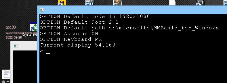

I understood the problem, in fact with win10, I have window edges reduced to the strict minimum, while with win8 I have window edges of standard size win10 win8 |

V5.07.03b1 MMBasic.zip DEFINEFONT now working. I had patched out the code during development and forgot to re-instate MM.INFO(OPTION CONSOLE) returns "Screen" for CMM2 compatibility reasons |

now my prog (testfonts.bas) work perfectly. thank Pete but I have always pb with "option default mode -16" who return same error |
This is correct. I made the decision not to allow full screen modes to be set as default. Full screen on Windows can be a problem (no access to menu bar etc.) so I thought it better to only allow it to be set once in the application. This is open to discussion but that was my thinking |

of course, but the problem is that this mode does not stay, and sometimes it starts to flash. Finally at each cls or at the exit of edition, the cursor disappears. We don't even know where we are anymore. Is the cursor just hidden or is MMBasic crashing. Even at startup, the version of MMBasic is not visible. it is unmanageable!!. There is a basic principle on Windows. The cursor at position 0,0 should be at the top of the visible part of a window, not behind the top border. And this, whatever the resolution. And if there is a menu, position 0,0 is at the bottom of the menu bar. it is Windows that manages this automatically, so any operation different from these principles must be considered as a malfunction Edited 2022-03-01 03:12 by goc30 |
How about I get rid of full screen mode completely but create a new mode for 1080p screens which is the maximum size that will fit above the task bar completely within the screen. Something like 1850x980? I can play with the setting to get the optimum |
