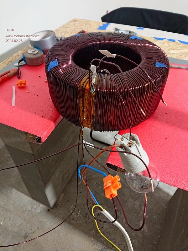

The third layer is already winded. I left some empty space in the first layer so that it could fit in the next layer. It turned out that the second layer was tight and the empty space was not used, similarly in the third layer. I measure the voltages on each winding and they are identical. The 40W serial bulb does not light up at all, it does not flash even during turning on. My clamp meter cannot measure such a small iddle current. It is possible to turn on the transformer without a light bulb and most turns it on without tripping the B16 fuse. |
-dex- Regular Member Joined: 11/01/2024 Location: PolandPosts: 49 |
I'm finishing the transformer. I added a small NTC temperature sensor. The first mistake also happened - I accidentally ordered the wrong cable for the primary winding. There is 50mm2 with 7 x solid wire, in a double rigid halogen sheath. Stiff as hell. Then finalyy I ordered a welding cable and it installed without any effort |

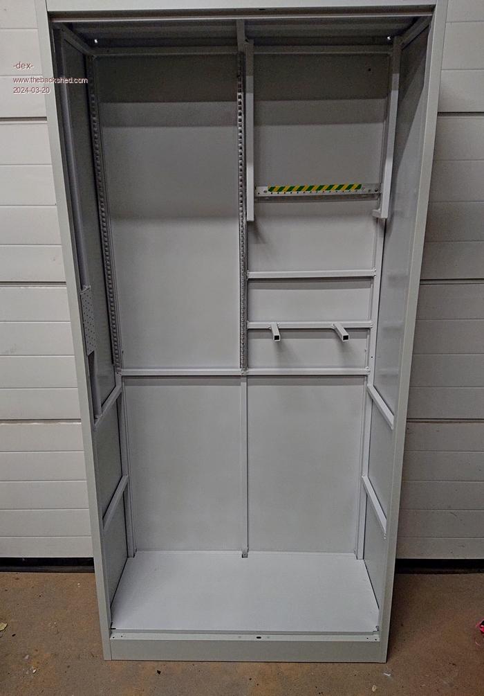

Housing The inverter, chargers, batteries and protection devices will all be placed in one steel housing with dimensions of 180x90[cm], closed with a key-operated door. It is made of thin sheet metal, so it requires several reinforcements and holders to which I can mount electronics and accessories. I'm not a professional welder so it's not perfect, but it should be durable. The painted casing is now drying and waiting. |

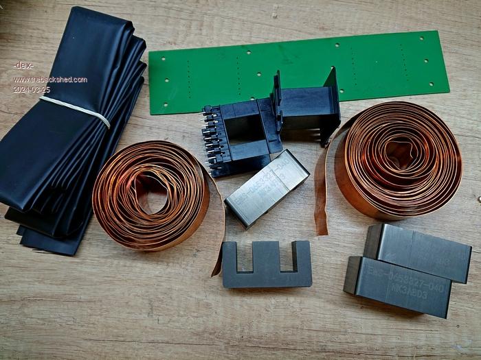

Inverter choke A core made of Sendust material, E type from Micrometals, mix 040 was used. A copper tape was selected for winding, dimensions 0.3x34mm, two in parallel. The measured value is 10uH, there is no more place for more. Estimated saturation current is ~300A and their saturation is not sharp but relatively soft. Made two such chokes, use in serial with toroid each leg. Used bits & core datasheet chK_core.pdf |

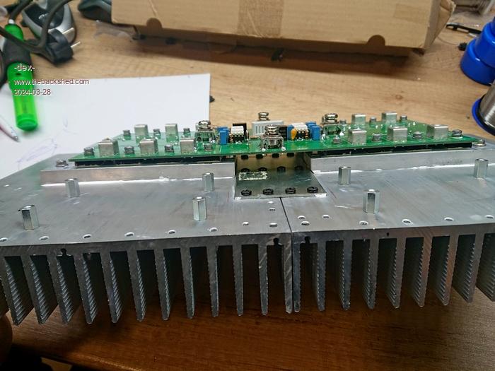

I will mount the electronics on heatsinks that I obtained after disassembly. As for their size for cooling purposes, they are probably oversized, so I may not need to use fans. MPPTs will also get the same heatsinks model, and the whole thing will have a modular design. More photos to explain this soon. |
KeepIS Guru Joined: 13/10/2014 Location: AustraliaPosts: 1399 |
That should run fine without any heatsink fan. It's looking really good. It's all too hard. Mike. |

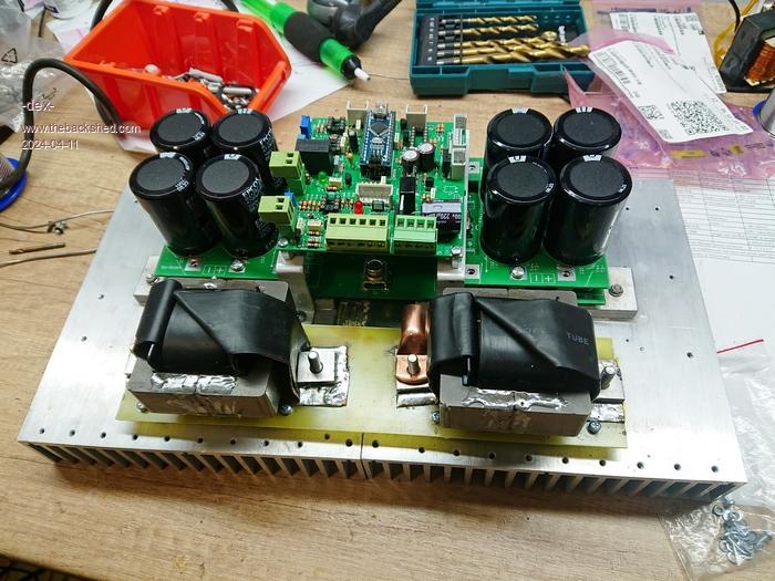

More photos of the work progress. The nano controller was assembled and everything was placed on the heatsink. Arranging everything in a sandwich makes the module does look like it feels packed and small. |

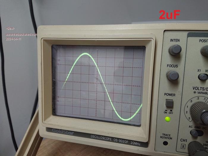

The inverter module has been checked and ready for first tests. Thanks to the wise instructions, the startup took place without any explosion or damage to the components. Now I need to choose the capacitor on the secondary side of the transformer. With a capacity of 2uF, the waveform has visible oscillation, but the transformer is relatively quiet. at 20uF there is no visible oscillation, but the transformer becomes noisy - a hum can be heard and vibrations on toroid are felt, and the no-load current is slightly higher. Do you have any suggestions for the capacitor? Warpseed suggested setting the resonance to 1.5x the mains frequency, but this has been questioned by some on this forum. |
Depending on the Toriod, 3uf to 5uf - 4uf is what I ended up using. Much higher then 6uf and you start to run into problems. IMHO 2uf is too low. I tested from 2uf to around 12uf with an AC distortion analyzer - no real benefit, it only effects Idle harmonics a bit, but not distortion under load, as it's swamped by the distortion caused by the crap loads. That was true for the Inverter and for AC mains. BTW Very nice build. I'm just starting on the second controller. . Edited 2024-04-11 18:51 by KeepIS It's all too hard. Mike. |
Murphy's friend Guru Joined: 04/10/2019 Location: AustraliaPosts: 602 |
What power level do you plan to use this inverter with? The copper dimensions you gave above for the choke winding is a bit on the small side for anything over 4KW, using a 48V battery. As you seem to have glued the E core halves together, the glue might soften if the choke gets too hot. I would prefer mechanical clamping for this task. I select the secondary capacitor with the 75Hz resonance test, worked for me. You are right, the no load current is affected by this capacitor value. Suggest you try those clip on noise suppressors on your AC wiring first and add a fully shielded AC filter for good measure. That should rid your wave form of that tiny oscillation, at least at lower power levels. |
The most common loads do not exceed 4kW. Sometimes it is 6-7 kW but it lasts no longer than 10 minutes. I will check with 4,7uF capacitor. I think I have somewhere metal-shielded emi filter so also will test this, thanks. |
