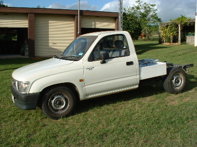

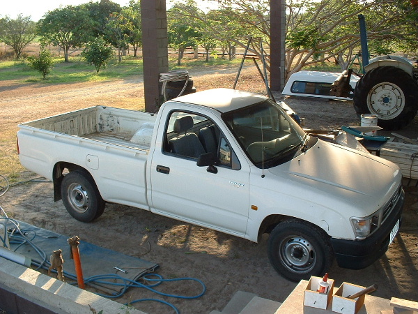

Finally started the Electric Vehicle (EV) conversion. The plan is now to focus with this to completion, so I will endeaver to keep you all updated on progess.

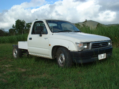

The vehicle is a 2000 Hilux.
For those of you that don't know, This extension to our business (EV Parts & Conversions) we have been working on for some time. We now have all the necessary bits and just starting the hard stuff now - remove all petrol equipment, design & manufacture the adaptors, battery holders, and fit out all the electrical stuff.

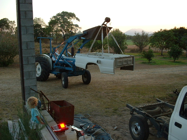

Canopy is off, Ute Body off, measured up for battery box to be fitted under tray, obtained steel and other materials. The battery box has been cut out.
You too can convert your car. Info gleaned from a number of sources, indicates that general cost for electricity is $1 per 100km. Petrol can't compete. And then with solar and wind power - you take a guess????????

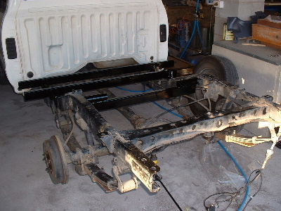

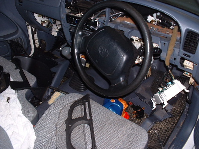

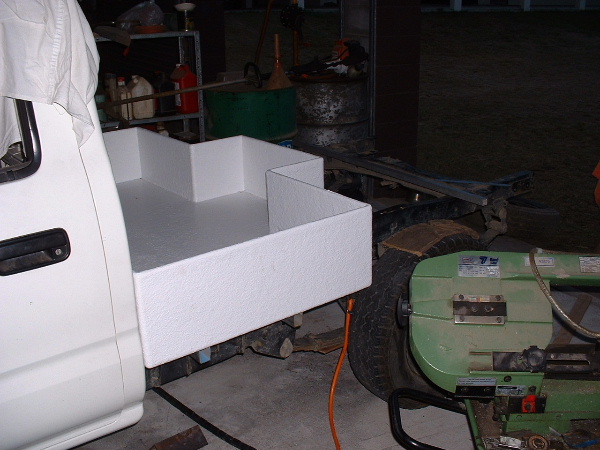

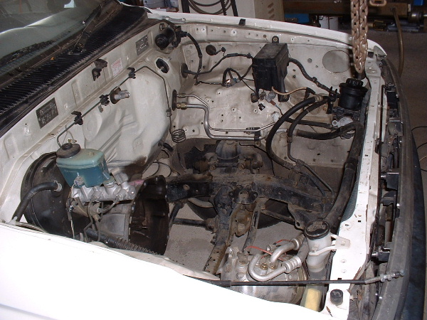

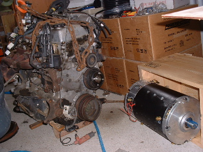

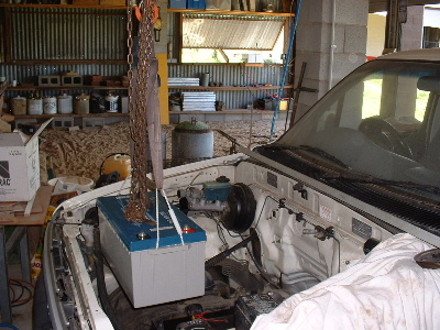

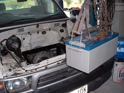

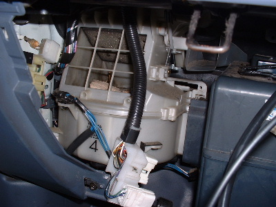

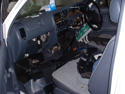

The vehicle now is stripped as much as posible. Engine, Engine computer control, radiator, exhaust, fuel tank, fuel lines, all clutch parts, air cleaner, bolts & brackets (everything possible) are all out. We have a pile of spares if anyone is interested????

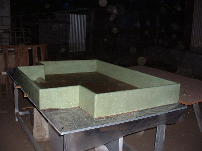

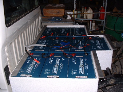

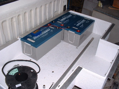

The battery box for the back (under tray) is made from ply and fibreglass coated inside & out. It will hold 10 x 226 A/hr batteries. Just sitting in place for the pic. The steel work is done underneath.

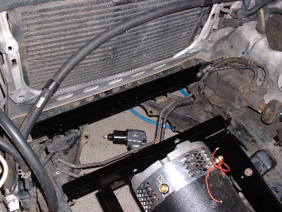

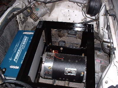

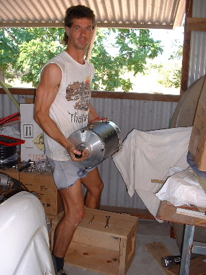

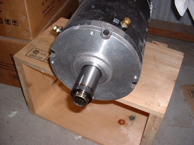

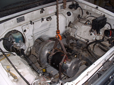

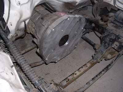

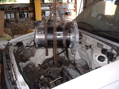

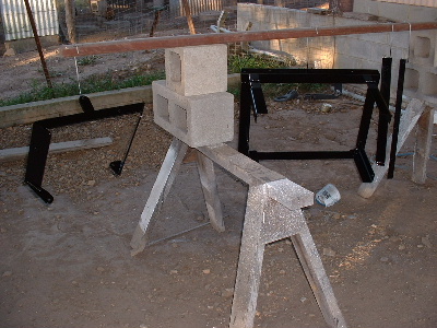

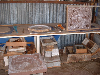

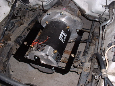

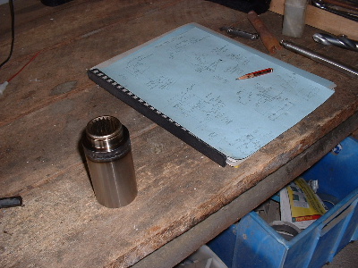

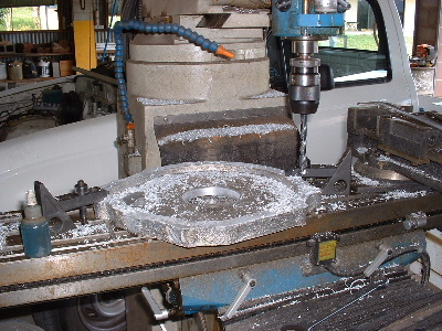

Started with getting the motor out of the box, measuring everything up, & drawing rough sketches of what had to be made to fit the motor to the gearbox.

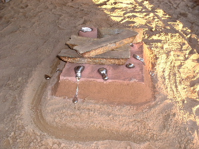

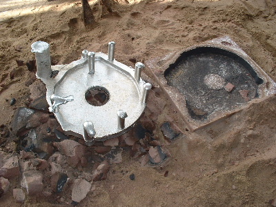

The adaptor plate pattern made from ply. Then kick the kids out of my sand pit (Foundry) and get the piece cast in alloy. Machine the adaptor plate on the mill. On to the lathe to machine the shaft connector. The spline is out of the centre of the clutch plate, the machined part is heat shrink onto this spline centre and then TIG welded. There is no clutch needed so it is removed. The motor stops when throttle is released. Gear changes can then happen, but is not generally needed because electric motors have all torque at zero revs and these will rev to 7000 rpm +. Just put in gear & away you go.
Motor was lifted in by hand... just joking...we did it with the chain block and fitted to the bell housing, shaft connected, & fitted perfectly.
Next is to make the engine mounts.

Feral, don't know the exact amp draw and its not correct but to get an idea divide the watts by the volts. No idea of the number of poles, these are brand new made by Advanced DC Electric Motors. I am using the FB1-4001 in this Hilux ute.
Glenn, you may do away with the gearbox, reverse can be done by reversing the poles on the motor, and speedo can be worked out by other means. It has been done before. Click on the link, scroll down to find the 'White Zombie'. It has no gearbox.

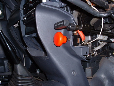

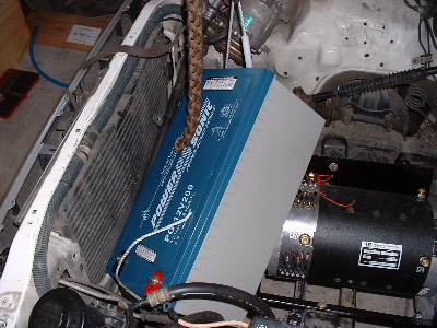

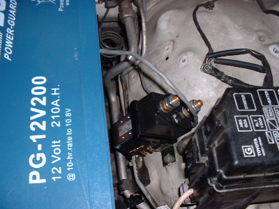

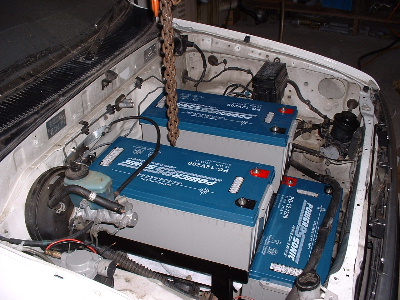

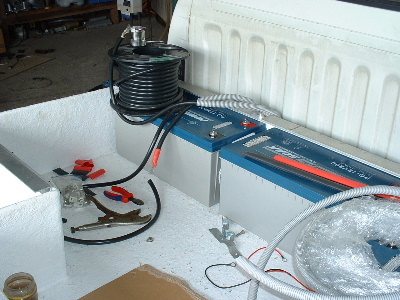

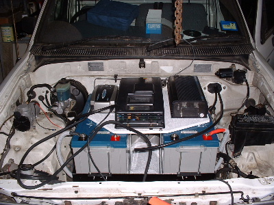

Engine mounts, and battery mounts made, painted and fitted. Steel under the battery box is also painted.
Of course there is always something to annoy along the way....battery rope handles......several batteries are sitting in place, 3 under the bonnet.
1 is for the 12v system, lights, blinkers horn etc. Normally it is not needed to be this big, but I plan to experiment - see if it is possible to run the air conditioner using the 12v system.
The other 2 are to be connected in with the 10 from the battery box in the back, thus making up the 144v system for the drive motor. The battery box is bolted down, with 3 batteries in.
The throttle potentiometer is fitted and cable is connected.
Main contactor is bolted on.
Vacuum pump is sitting where it needs to go.

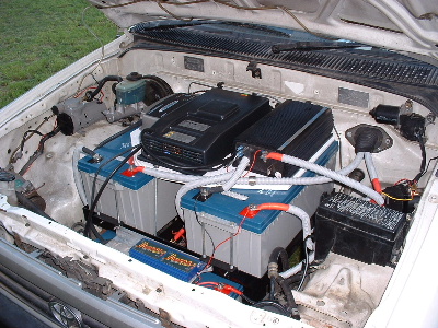

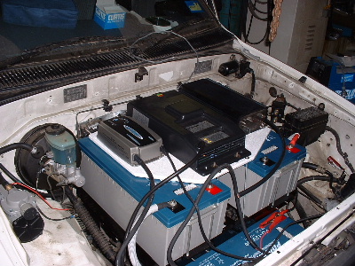

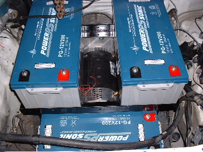

Some very exciting happennings this week, mounted the motor speed controller, 12v battery charger & the 144v battery charger. The vacuum pump is mounted. The BIG RED knob(safety push button)is also mounted. All batteries are fitted.
Then to running the cables. Excellent. We have acchieved the 144 volts at the front, with 50mm cable clamped securely underneath from rear battery box to the batteries at the front, in flex conduit. The 50mm cable lengths are cut to connect the BIG RED knob. Still to connect is the Main Contactor, Speed Controller, & Motor.

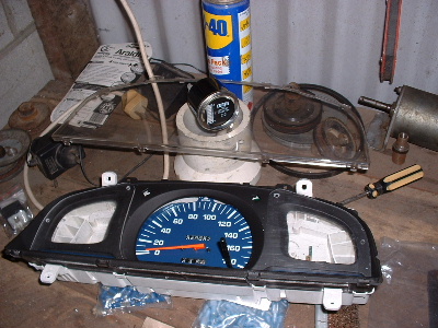

But of course there is the dash, my intention is to make it look authentic, not just adding higgilty piggy.
There are still some panel meters I wish to put in, but don't have yet. In the pic of the instrument panel you can see the 'fuel guage' for the 144 volt system.

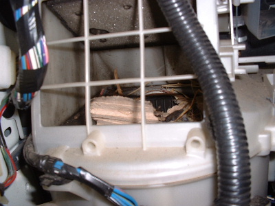

As for disasters this week, none really...... but I hate RATS. Found a nest in the air-con fan.

The motor is up and running yesterday. 12v charger is now connected. The 144v will be soon. And the Megapulse units.

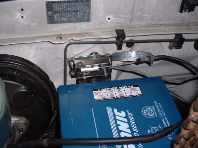

Got the 144v Zivan battery charger connected and left both this and the 12v charger run to charge up the batteries, while I continued tidying up some minor things.

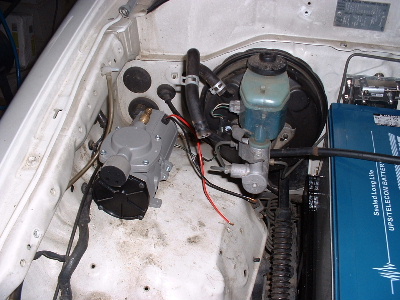

The vacuum pump for the brakes fitted and connected. It is activated when the brakes are applied. This is the only thing Marcy doesn't like. It sounds like some one doing a big loud fart!!! Some did say once, "skid marks" in that part of the clothing.
The Megapulse (battery desulphator) units are fixed and connected in the front, except one, ordered another batch (any body want one). These in the front are all 12v units. In the back, there will be 2 x 48v Megapulse units and a 24v Megapulse unit. It would have been better if I had all the batteries for the 144v system in the back, then I could have just used 3 x 48v Megapulse units.

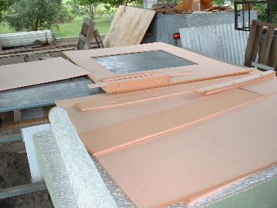

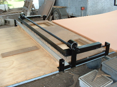

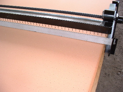

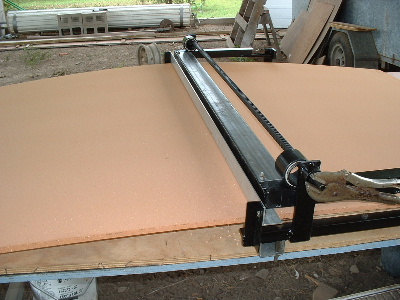

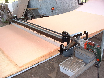

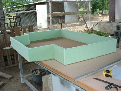

Not much done to the EV this week. Wasted too much time building a hole punch machine,(& dismantling, modifying, & reassemble too many times).
In the past I used to have the holes put in at Foxcon Aviation. If you want a good, extremely light F/g plane, these are worth a look. I cast & machine the reduction drive units, front wheel mounting, and the brake parts, for these planes.

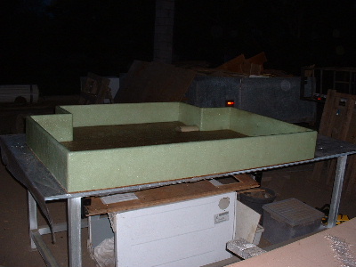

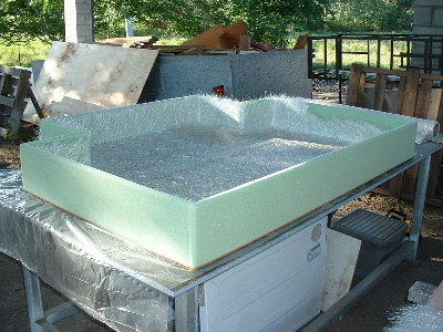

The 5mm Klegecell foam is Ok with the drill to wind it through, but the 12mm is just too much. I had to wind it through with a vice grip as a handle. The holes are to add a sthrengthening tie between the layers. Just like the centre of an I beam.
I used the 5mm Klegecell foam for the base on the rear storage box, ( which fits under the tray) and 25mm Polyurethane foam for the sides. The top - the tray itself - will be made from the 12mm Klegecell, all glassed over. It will be very light.

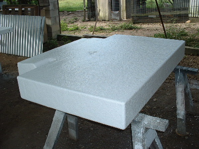

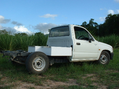

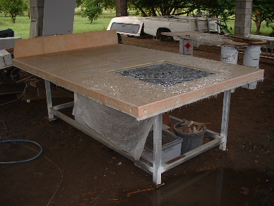

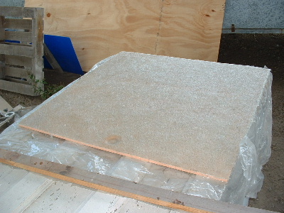

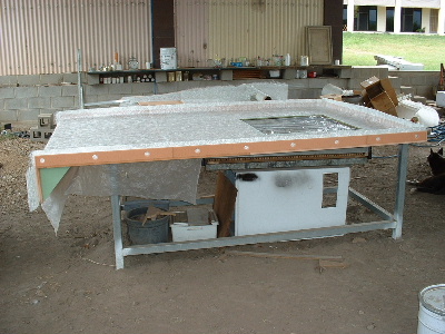

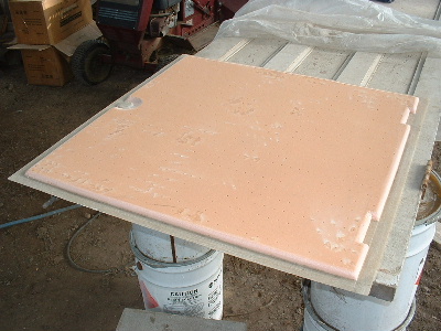

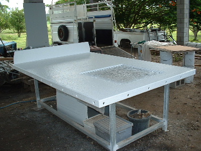

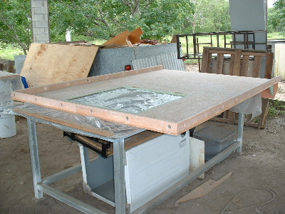

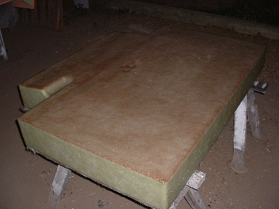

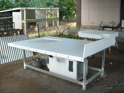

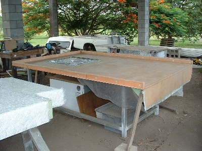

More foam & fibreglass work. The rear storage box is glassed on the outside. The tray is together now with only the under side glassed.
Edited by Trev 2007-01-19
Trev @ drivebynature.com
Trev
Joined: 15/07/2006
Posts: 676
Posted: 11:15am 25 Jan 2007

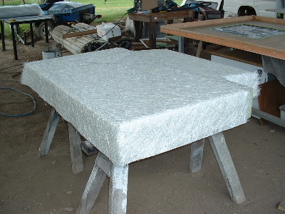

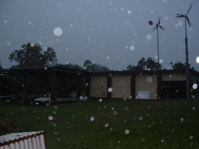

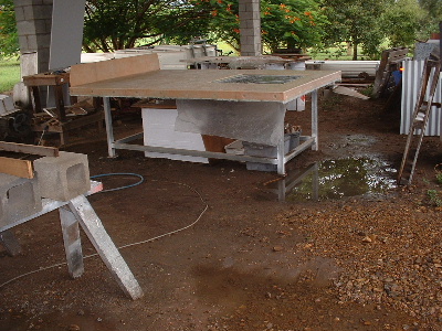

Difficult circumstances has hindered progress with the fibreglass work. High humidity and wet, wet , and more wet. 275mm.
Just for Bruce - 10.8 inches.
A pic of the rain, the flash picks up some of the rain droplets. It also shows where a storm took out the tail on the double White Pointer wind gen. It was only a piece of acrylic. One day this will be made of fibreglass. Nothing else damaged.
We had not long finished laying the glass on the top side of tray and down came the rain and very strong wind. I am glad the resin had gelled off, or else there would have been a real big mess.
The top side of the hatch lid is glassed. The indent is for the lock to go in, so that the lock will not be higher than the top surface of the tray.

The hatch lid has been cleaned up & underside foam is shaped for the lock & hinges etc. I did get glass on it, but not photo'd.
Another whole day with the fan on the dash. It really had me confused for so long, but I have discovered that Toyota have used negative switching for a positive power. It has nothing to do with the engine control computer, as I originally thought. It appears to be a break in the wire somwhere. Still will require more time.
