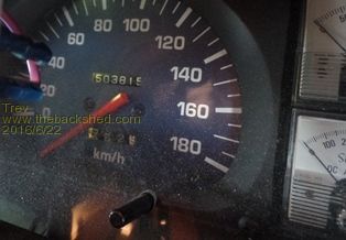

The third set of new brushes is now fitted to the WarP 11 motor. The second set of brushes started at speedo reading 444158. The speedo reading now is 503815. That's 59,657km for the second set of brushes. Very close to the first set of brushes that lasted 59,288km. A new VDO satelite speedo fitted a while ago. It now has a reading of 17227.4km. Trev @ drivebynature.com |

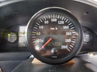

Cost of brushes, don't know. We are just passed 3 years on the second set of lithium batteries (52 cells x 260Ah). The speedo reading from last year 481132km to now at 506725 = 25,593km for the past year. Speedo reading when batteries were fitted 437956 to now 506725 = 68,769km over 3 years. Pictures of original speedo and VDO speedo 20155.4km. No issues with this battery pack. Just last week I had no auto balancing system installed and the pack stays in balance still quite good over a few days of testing. No sign of capacity loss but I am not discharging very low to find out either. I have had the new concept Relativities prototype auto balancers across this pack for a good while. They do work well but will most likely not be made commercial. A few weeks ago I had been testing a new auto balancing system but something seems to be wrong that I have not been able to work out yet. I have them all removed until I have more time to test them more. Preliminary testing on my camper battery seems ok, but something is not right in the Hilux. Trev @ drivebynature.com |

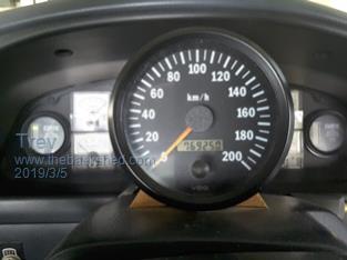

Another year has passed since fitting the 52 cells x 260Ah battery pack. Last posting was - New VDO is now at 40712km + 48632km = 89344km traveled to date. VDO speedo reading now is 64137 - 40712 = 23425km for the past year + 89344km = 112769km in total over 5 years. I am not sure of the old speedo reading accuracy. The needle does not show speed anymore. The numbers still go around and I think its still reading ok. The old speedo reading is 550451km. The battery pack is still holding up ok. There are some cells that have a higher internal resistance now, showing a voltage sag when under heavy current draw. We have done a number of long drives now. I figure we have lost some capacity, but I have discharged 30kW from the pack, and possibly still has some more. I just don't want to damage the pack by discharging too low. It is still at least or over 150km range. Two examples I have taken some pictures. Driving conditions, wind, terrain etc do make a difference to what you can achieve. 135km using 23.1kW. Don't take any notice of the temperature in the monitor screen. It is not that hot. 139km using 27.7kW Trev @ drivebynature.com |

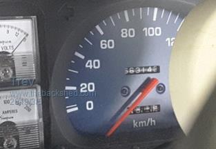

The third set of brushes is done. Forth set now fitted. Old speedo reading now, 563143, minus speedo reading when fitted 503815 = 59328km VDO speedo reading now, 76925, minus speedo reading when fitted 17227 = 59698km All 3 sets of brushes have lasted just over 59,000km. Re:- Glenn, new brushes AUD$460. I dislike very much the USD/AUD exchange rate, it makes the Aussie dollar not worth much. It makes our prices so high, because I have to pay more. Trev @ drivebynature.com |

There is quite a bit of news worthy of posting, so I will attempt to play catch up in the next few posts. We are now passed 6 years for this lithium pack. VDO speedo reading is now 88599km - 64137km = 24462km for the past year + 112769km = 137231km in total over 6 years. Old speedo is still turning around, the reading is 574725km - 437956km = 136769km recorded over the past 6 years. November last year 2018, we won the Glen George trophy for the longest EV drive to the AEVA show. This AEVA conference & show was held in the Brisbane Convention Centre. I only presented T-Rev for show as the space was limited and the costs were high. A long day. Bump in (setup) started at 7am. Visitors started at 10am and went right up to 7pm. There were a lot (a real lot) of visitors. Security were assisting in getting them all out at the end so we could pack up and get out. It was a great show day. We got out by 8pm. Here is a snapshot of the charge points on the journey. One camping spot was Childers. Childers charge point is in the back of the RV motorhome/caravan free camping spot. A great location. Then all the same charge points in reverse on the way home. Different charge points in the dark. Carmilla, the last public charge before getting home was in the light. You can find all the charge points at https://www.plugshare.com/ Edited 2019-09-02 12:06 by Trev Trev @ drivebynature.com |
