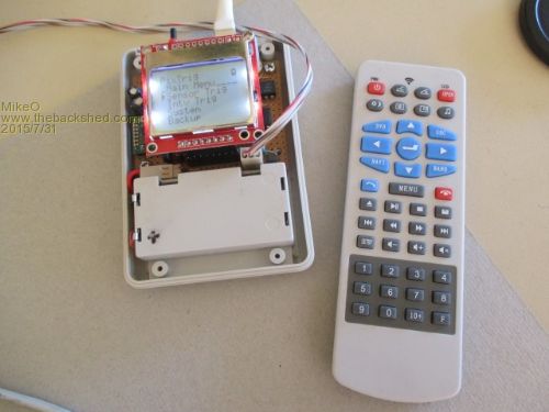

Just completed a MM2 version of my picaxe camera trigger "PixTrig". MM2 has allowed a much nicer and convenient menuing and display (using Nokia in this version), IR keyboard imput, plus many more features. Currently it allows for 2*Flash, 2*Sense (Digital, Analog, mixed), switched output for Water drops solenoid. Sensor Trigger and Invalometer modes. Battey driven, sleep mode etc. Latest code and Schematic will be on my website thus weekend. www.codenquilts.com.au
Cheers Mike.
