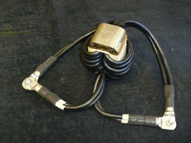

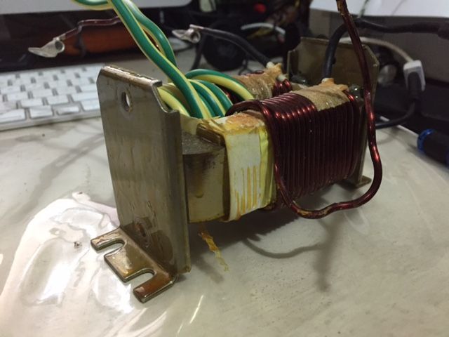

Madness, this inductor is out of a smaller Aerosharp.
The 3000W units have a different two part choke I think and it is
potted in silicon.
Anyway, here it is, I hope this helps.
iron laminated core, 17mm x 25mm rectangular section.
I unwound about 30 turns of one side to leave me with the 13.
Winding wire is 3mm diamater (7mm2) copper on the 13T, 6mm2 on the 6T.
Posted: 02:28am 15 Mar 2017

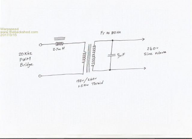

I can tell you all about those chokes, I have several here pulled from 1.5Kw Inspire grid tie inverters. Not identical but almost so.
This choke, along with the toroidal transformer, and a 5uF capacitor form a very clever composite filter to turn the PWM into a nice smooth sine wave.
The 5uF capacitor and the transformer secondary form a tuned circuit resonant at roughly 1.5 times 50Hz. The reason it is not tuned to exactly 50Hz, is that would cause a massive uncontrollable build-up of voltage under no load.
By tuning it to 1.5 times the frequency, any stored resonant energy in one cycle appears exactly out of phase during the following half cycle.
This 75Hz resonant circuit, particularly the 5uF capacitor will have a rapidly decreasing impedance at frequencies higher than 75 Hz, and will greatly attenuate the 20 Khz PWM and its harmonics.
To assist this, and not shunt the PWM bridge with a very large capacitor, a series choke is fitted that has a low impedance at 50 Hz, but a very high series impedance at 20 Khz.
This combination is an excellent way to turn high frequency PWM into a 50 Hz sine wave with very high attenuation of the higher frequency components.
There is also the hidden advantage that the circulating energy between the transformer secondary and capacitor, even though it is not resonant, reduces the effective magnetising current (as seen by the PWM bridge) and no load loss created by the transformer.

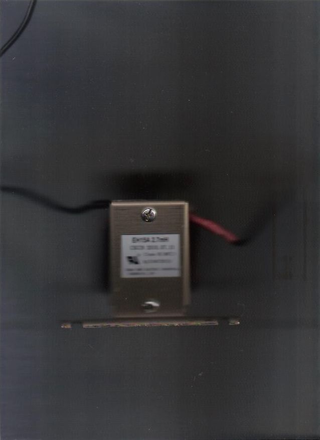

The choke you have is not a common mode choke, although it looks exactly like a common mode choke. The phasing of the windings will be different.
Your choke will be a split choke with half the turns on each side, which is a much nicer way to do it than the Inspire choke which is all on only one side of the PWM bridge.
The coke I have here is marked 2.7mH, but it actually measures closer to 3.4mH. The inductance is not that important. I cannot remember what I measured as the saturating current, but it was pretty high, 40 to 50 amps as I recall. So it must have a very large air gap buried in there somewhere.

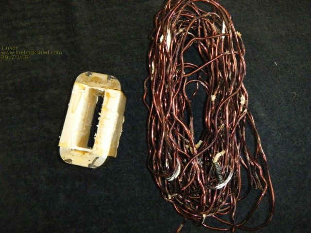

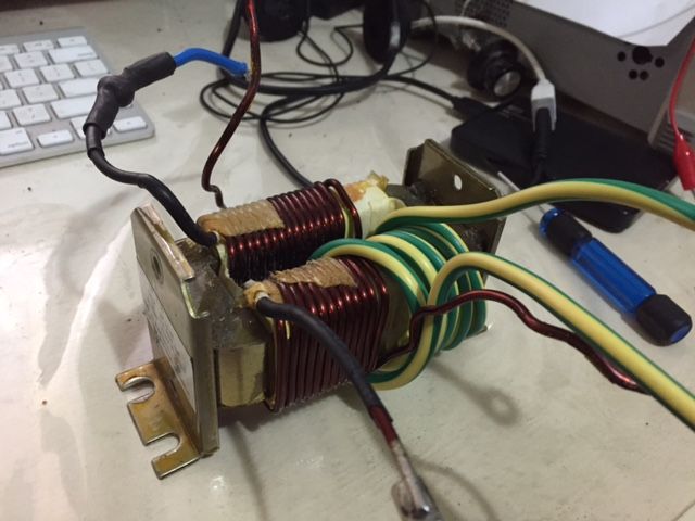

So I grabbed the 3KW Aerosharp choke I had and unwound it.
Its quite a job but fortunately the 3mm wire is stiff enough to push it through the slot.
The first hurdle is to undo the clamping bolt, the nut only budges after it has been persuaded with a little blow torch .
Then I ended up with this:
900gram of scrap copper wire and a core with an opening of 70 x 16mm.
The choke as it was is is no good for the rather high primary currents I expect on my inverter.
So I rewound it.
20 sq mm cable just fits 16 times into that slot. This gave me me 4 turns of 80mm sq. (4 x 4 in hand)
Now it looks like this:
The rather unorthodox winding style was because the only way I could fit the wire was to push it through from the same side, using no cross overs.
As shown its connected for 4 turns but by opening one side it could be 8 turns of 40 mm sq. (2 in hand).
Tomorrow might be a chance to see if it works any different from the ferrite chokes I have been experimenting with so far.
I hope the core is laminated from a continuous strip - I did not remove the insulation to see if it was a split C type core. The laminations are very thin though.
Posted: 10:48am 16 Mar 2017

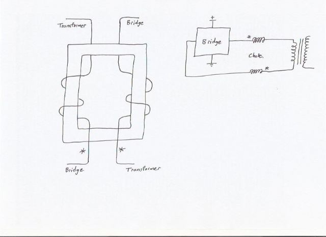

It will be a split C core with a pretty big air gap. This is going to behave very differently to an ungapped ferrite core.
A ferrite core will very quickly saturate at only a very few amps, so its only going to do anything during the very short time interval the mosfets are switching.
This gapped iron choke is going to be a full time inductor,its going to be there all the time with the full inductance.
From memory my Inspire choke had 42 turns on each side (84 turns total) and 3.4mH.
If I rewound that with 8 turns total, the inductance would fall to 32uH.
The saturation current of the original was somewhere around 45 amps, that will have now increased to maybe 460 amps.
So that 32uH is not going away.
This is going to be very interesting. Just make sure you have the two windings phased correctly so they are in series.

It kind of worked, with the windings connected as 8 turns in series and used on one side of the primary.
The idling current was higher than either of my ferrite chokes (E-core & ring core).
With a load (I only did up to 600W) there was no squiggle at the zero crossover.
Now I'm getting more cable lugs so I can re connect the 6 turns on my ring ferrite core into 12 turns.
From what I learned so far, more turns = lower idling current.
I'm still waiting for the little inductance meter I ordered from e-bay. I should then be able to measure what inductances my choke variations have.
