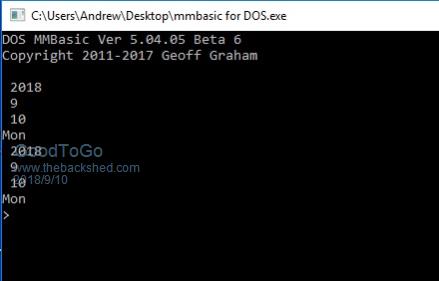

Hi Lew,
I tried your code in DOS MMBasic ver 5.04.05 Beta 6 and it worked fine after I made a couple of edits:-
I had to declare the variable DOW$(6) at the start,
I commented out the 'do'
I commented out the 'dowx1$=DOW$...etc etc line.
dim DOW$(6) as string
DOW$(0)="Sun":DOW$(1)="Mon":DOW$(2)="Tue":DOW$(3)="Wed":DOW$(4)="Thu":DOW$(5)="Fri":DOW$(6)="Sat"
Year=Val(Mid$(Date$,7,4)):Month=Val(Mid$(Date$,4,2)):Day=Val(Mid$(Date$,1,2))
'dowx1$=DOW$(DayOfWeek(YEAR,MONTH,DAY)) 'DOESN'T DO ANYTHING BECAUSE dowx1$ IS NEVER USED BELOW
'do 'THIS DO DOESN'T DO ANYTHING BECAUSE THERE IS NO LOOP BELOW
  print DOW$(DayOfWeek(YEAR,MONTH,DAY))
  pause 2000 'YEAR, MONTH, or DAY don't change during this pause
             'DATE$ will change if you pass midnight during the pause
             'but YEAR, MONTH and DAY still won't change unless you specifically
             'set them again with line #2 above
  print DOW$(DayOfWeek(YEAR,MONTH,DAY)) '@print 2nd time to see if it changes the day after a pause
end
function DayOfWeek(year, month, day)
  print year 'to check if it's correct
  print month 'to check if it's correct
  print day 'to check if it's correct
  local a,m,y
  a = int((14-month)/12)
  m = month + 12*a - 2
  y = year - a
  DayOfWeek = (day + y + int(y/4)-int(y/100)+int(y/400)+int(31*m/12)) mod 7
end function
And the result was:-

Thanks G2G
I thought I'd got everything correct
In my code I had
DIM DOW$ and not DIM DOW$(6)
Tiny little error but stopped it working
Thanks for spotting that
Yes the Date format is the same dd-mm-yyyy
Lewis

Posted: 10 September 2018 at 11:58pm | IP Logged Quote matherp
Quote:
In my code I had
This is an error that should be getting caught by the MMBasic parser when you assign to DOW$(n). I've reported it to Geoff and I'm sure a fix will be included in a subsequent version of MMBasic so that it does generate an error.
DIM DOW$
DOW$(1)="test" ' this statement should generate an error
Back to Top View matherp's Profile Search for other posts by matherp
