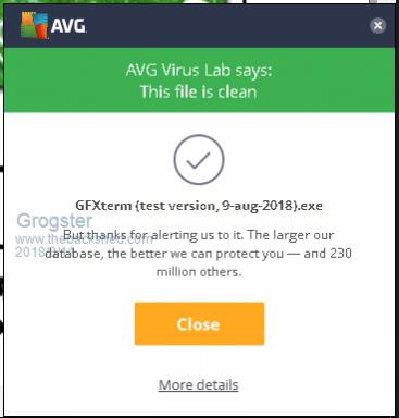

Posted: 11 August 2018 at 9:16am | IP Logged Quote Grogster
NO, I WAS USING AN E28 MODULE WITH THE 1455 INTERFACE!
I will try a 2102 soon, and let you know.
As to your three points:
1) YES - within about half a second.
2) YES - nothing else seemed to be affected(my mouse and KB are also USB)
3) YES - Plugging in flash-drives etc did not upset GFXterm's connection.
On another subject, AVG labs have reported your file as clean.
We all knew it would have been, but it is always nice to get the confirmation.
