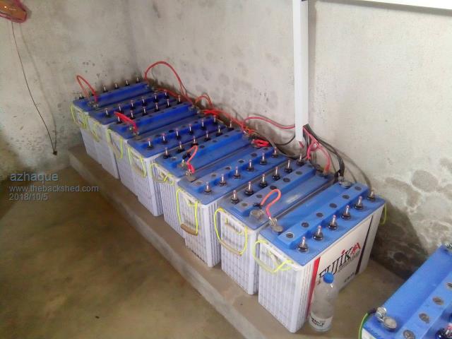

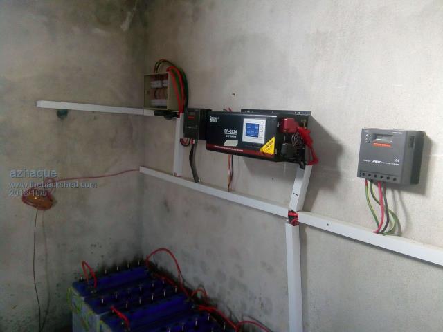

I am using EpSolar VS6048 PWM (pic shown below) Charge Controllers for my 12.5 KW solar array. The CC is rated max 48VDC and 60 Amps.
There array is divided into two parts for redundancy. The picture below shows the 24VDC 3KW inverter, with its accompanying battery bank (next picture). Two charge controllers can also be seen in the pic, that provide solar power to the inverter/battery.
The system is mounted on a wall in the garage. It is pretty inconvenient to go to the garage, unlock the gate and then check up the system. So a need was felt to get the data wirelessly.

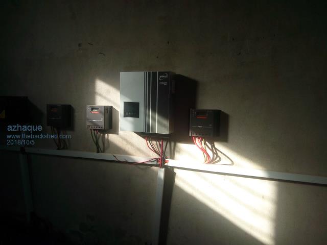

Posted: 05 October 2018 at 10:41pm | IP Logged Quote azhaque

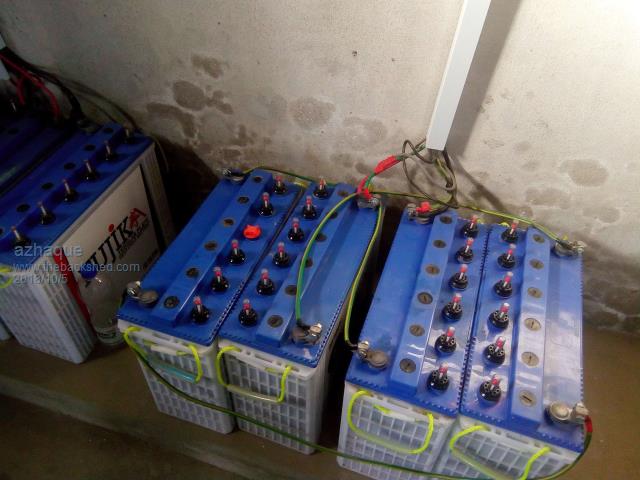

I forgot to post the pics of other inverter and battery (the sun is shining on the inverter thru the garage ventilator). This is 48VDC system with the inverter rated 5KW. 7.5KWs of solar power is fed to this inverter/battery pair using 2 nos. 6048s (can be seen in the pic). This system is dedicated to run the fridge and the deep freezer and other power devices in the house.
Incidentally its all off grid.

Posted: 05 October 2018 at 11:11pm | IP Logged Quote lizby
Nice-looking setup. How long have you had it running and what kind of charging input are you getting per day over what period of time?
Are the lugs on the batteries so that each cell may be separately monitored?

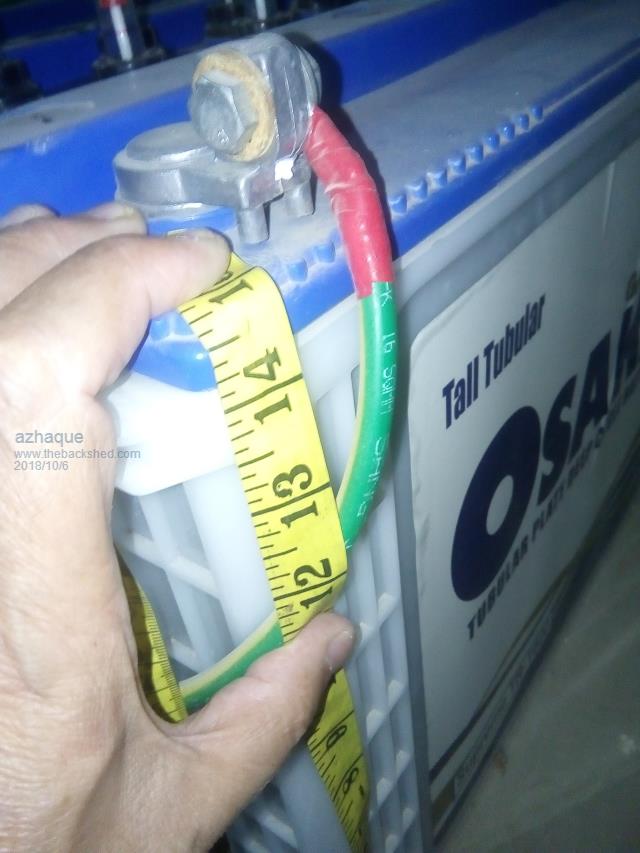

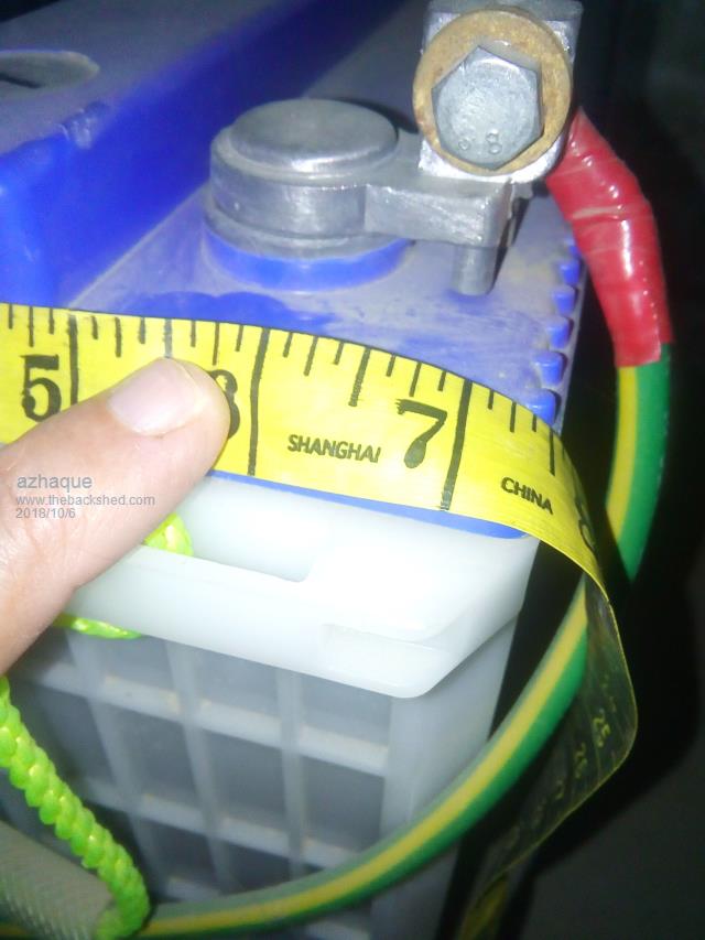

No. Please note that these batteries are series-parallel strings of 12 VDC, 160 AH tubular plate units. In the 24 VDC sub-system, these are strung in 2 units/series string, and 4 such strings in parallel. In the 48VDC sub-system, it is just one string of 4 series connected units.
Your question about monitoring each battery separately would make a cumbersome and complex system. Whilst ideally it should be like this so that one can monitor each unit separately, however the complexity of it would be formidable.

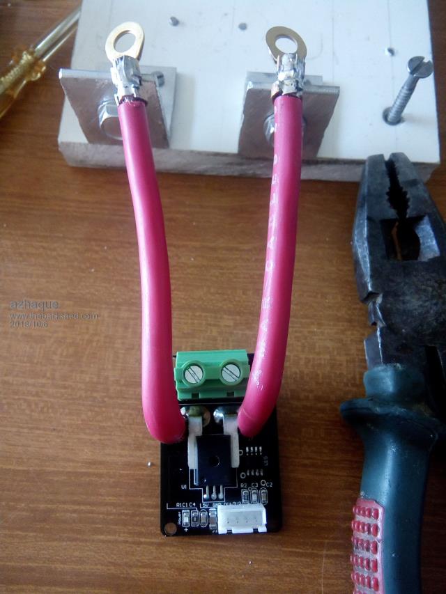

I plan to just monitor battery statistics on this wifi system including battery current, both in and out, SOC temp. etc. Hopefully with this info plus visual inspection and keeping the water topped up should keep the batteries warm and cozy. I have already fabricated an ACS758 based sensor for that
purpose (pics below).

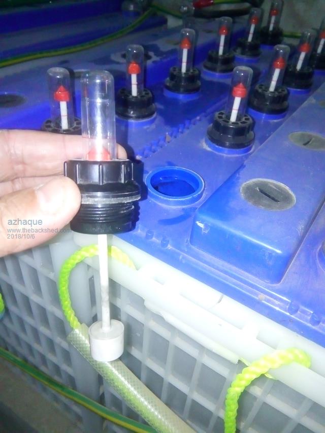

By "so that each cell may be separately monitored" I was talking about what appear to be screw posts (but maybe not) next to each of the 6 openings for water on each battery. I've never seen that, and wondered what they are. They look like heavy duty batteries.
Back to Top View lizby's Profile Search for other posts by lizby
These screw posts are just level-gauges for the electrolyte. I have added a pic of the same. Sure helps to avoid peeking down the water hole of the cell to ascertain whether it needs a top up.
The batteries are Tall Tubular deep cycle batteries. The plate geometry is tubular instead of the usual Flat one. Locally manufactured by a company called VOLTA ( volta.com.pk ). My son has a friend who works for the company. So we get a price with a nice discount. The factory is also not very far away so cartage cost is minimal. We lugged two of these in the back of our van and brought these home. Pics with measurements attached. About twice as high as a normal 200AH car battery and about the same width.

Ok, I see--so visible electrolyte gauges--nice touch.

The old exide batterys had a similar float on them (built into the watering cap) and they are indeed a huge timesaver, I had a set back in the 90's, the monthly checkup took literally seconds in most cases... walk into shed- look along floats- if all blue, do nothing, if red, top up (they even had flip open lids rather than the screwin style)
These are similar, but lack the top up flip open lid
water level caps

Hi all,
First the progress this weekend.
Got the veroboard populated. Got it to run BLINK . Here is the video.
https://www.youtube.com/watch?v=cbtMSwUkMJs
The module on the left side of the board is the power supply which provides both 5VDC and 3.3VDC. Very convenient to put onto the veroboard.
Next board with the blue blinking LED is the NodeMCU with BLINK loaded and running.
The small red thing in the middle is the bi-directional level shifter. Another one is yet to be installed.

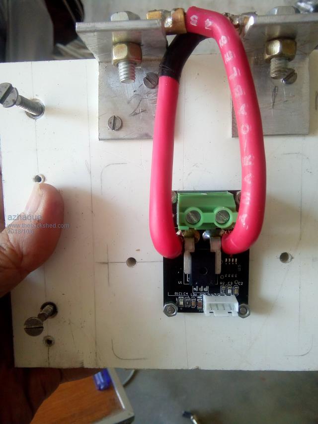

The connectors on the right are for the MAX485 modules. I did not have these plugged in when I made the video.
To return to the design.
As I submitted above I had planned to follow paulca's conceptual design, given in his post in eevblog (link provided in an earlier post). The conceptual design is given in the schematic copied below.
The variation in my design, from the above is, that there would be two streams of MAX485 instead of only one in paulca's design given above. The only issue is whether I would be able to swing two serial ports on the ESP8266. Research on the Net shows that it IS possible despite the fact that the example videos are very very rudimentary.
Secondly it has to have the capability of reading the output from an ACS758 thru the on board the ESP8266's a to d converter.
Wish me luck.

Posted: 09 October 2018 at 3:13pm | IP Logged Quote bigmik
hi azhaque,
looks great.. Err except some of your wiring looks a bit `how you do it'.
I hope the HV and LV wiring is separated and not all in that ducting.
Comments (critical but only on a constructive intent)
Ducting is too narrow (looks like 25mm)
Ducting looks like it is mounted at angles in places and too many cables inside.
Some wiring on your batteries from `GND' pass through the `12V' wires at the terminal (keep these in neat runs apart from each other)
The wiring to the current sensor could be cleaned up so there is no chance of shorting (not that it would cause an issue if it did) maybe mount the sense PCB 180degrees rotated.
I am rather jealous of your setup but IMHO it doesn't look as good as it deserves to.
Please take those comments as I intend them .. I am not CRITICISING just pointing out some simple things to make it a better project over all.
Anyway we are all hobbyists keep up the good work.
