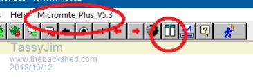

Posted: 12 October 2018 at 6:40am | IP Logged Quote TassyJim
First, make sure you have the correct syntax file selected. It has to be one of the versions that allows saving to SD.
Open the file manager.
select the file on the PC and transfer to the 'mite.
Check out 'file manager' in the help.

Posted: 12 October 2018 at 7:49am | IP Logged Quote lizby
Ok, thank you, Jim. Got it.
One snag along the way--when I click on the version-choosing item to the right of "Help", I can only see some of the options, and see no way to scroll. I clicked the bottom option, clicked the chosen item again, hit the down arrow, which chose the next, invisible option, and then repeated that until I got to Micromite_Plus_V5.3.
