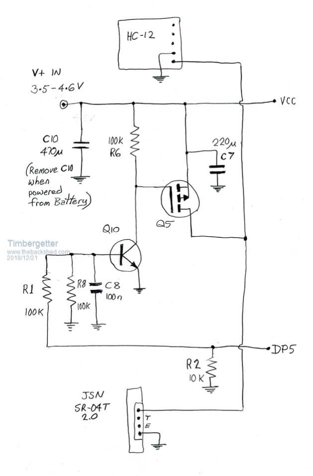

Grogster wrote:
CaptainBoing wrote:
Which MOSFET did you end up using Grogs?
I used a DMP2305, which is SOT-23, and has an RDS of 90 milli-ohms at -2.5v
Vdss of -20v, Vgss of +/-8v, I=-4.2A. I helped that along with an FMMT493 NPN transistor in SOT-23.
Grogster, I found the above image on another thread and I guess it is the circuit you are referring to. You desribe it further in that thread with the following:
"This was what I have been using up until now, but it requires four extra SMD parts.
It is a high-side switch for just about anything with a common-ground.
I used 1k for R7, 100k as the R6, the NPN I used was an FMMT493 in SOT-23 flavour, and the MOSFET I used was a DMP2305 also in SOT-23. "
Many thanks for all your info.

Grogster, I was wondering if you could tell us a source for DMP2305 that doesn’t involve outrageous shipping costs to Aus? Mouser seem to charge a min of US$24 for that service.
Back to Top View Timbergetter's Profile Search for other posts by Timbergetter
disco4now
Joined: 18 December 2014
Online Status: Offline
Posts: 281
Posted: 12 October 2018 at 10:25am | IP Logged Quote disco4now
RS Components have free shipping. You get 100 for $13.50
rs components
Back to Top View disco4now's Profile Search for other posts by disco4now
Avatar
Joined: 31 December 2012
Posts: 6128
Posted: 12 October 2018 at 10:46am | IP Logged Quote Grogster
I got mine from Element-14 at the time:
Link.
74c each in NZ money, and freight is free if you buy $50 or so worth of parts.
I usually combine my orders so that when I make an order from Element-14, it is at least $50 so I can get the free courier. Otherwise, it is $15 I think.
EDIT: Disco's link is a better price. I'd buy them from there, but you might not want 100 of them.
These MOSFET's have a maximum Vgs of 8v, so you can't connect the arrangement from the photo above to more then 8v or you will probably destroy the MOSFET. As the HC12 only needs 5v, they are perfect for that. Just don't go putting 12v on it like it shows in the diagram above!

Thanks disco4now. 100 units on its way now. That should keep me out of trouble for a while!
Thanks Grogster for the Element-14 tip.
