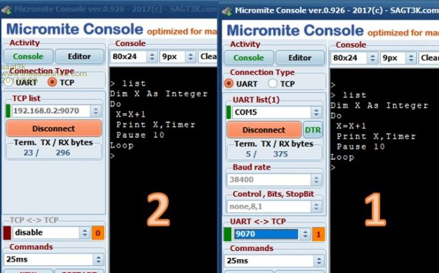

- Concerning the file .cfg, You do not have to handle or edit the file.cfg . All configuratios reflect settings at program closing.
- MicromiteCons is a portable software, than you need permission on directory where reside file.exe.
- [TCPlist] is populated when you type an IPaddress:Port. When press Connect, this IPaddress is added in the list. To remove it from the list, select and press CTRL+DEL.
- Short Command as the same function of TCPlist. You can digit complex instruction and press SEND. To remove it from list,select and press CTRL+DEL.
Here you can download vers. 0.927 new version.
+ Improved TCP Client/Server management and fixed a few of bugs.
Here is an example, two connections, one with an UART with TCPserver enabled on port:9070. The other as a TCP client connected on 192.168.0.2:9070
Antonio

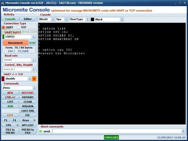

New version 0.929 of Micromite Console:
+ some display issues solved when is connected with TCP/port
+ added CPU frequencies for MMX
+ added button Keys (F3,Shift-F3,F4,F5)
download v.0929
report VirusTotal PASSED
Antonio
