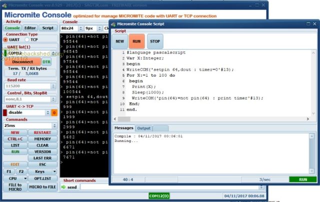

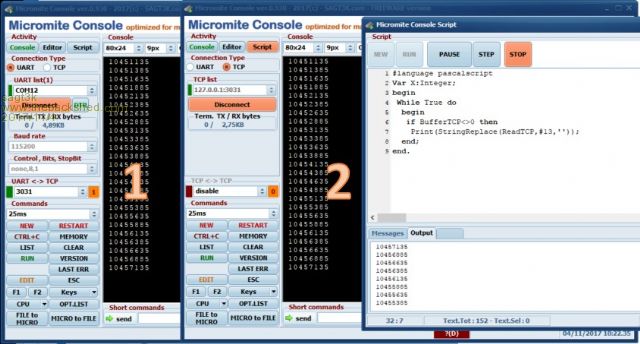

In this example, there are 2 sessions of MicromiteConsole.
1) The first is connected to the COM(12) port with a Micromite64 and put in the TCP/server port 3031 the serial, such as ser2net.
2) In the second session of "MicromiteConsole" a connection to the TCP/3031 port is active and in addition, a script that reads the TCP buffer and prints on the output of the script module.

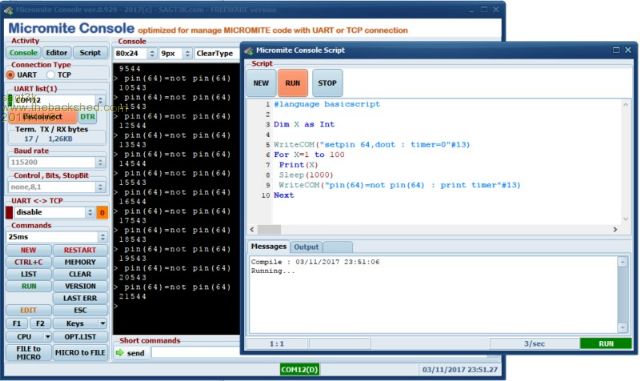

Hi to everybody
A video that demonstrates the script on Micromite Console:
Micromite Console: Example with script (01)
Antonio

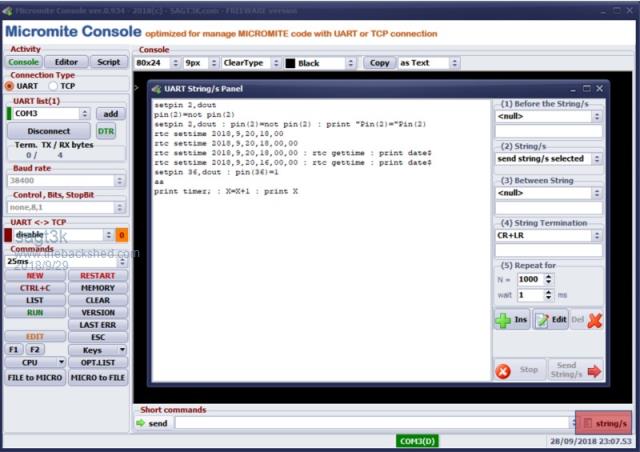

Hi to Everybody
I announce a new version with a new feature:
- add string panel to send strings with different functions,
send special hex/chrs or sequences, before, between or termination when sent single or multiple strings.
- the button "string/s" is enabled when a COM is activated
Here the link for download v.09.34
Every comment and / or suggestion is appreciated
Antonio

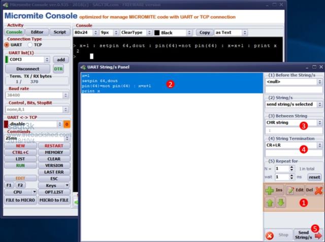

Hi to Everybody
I announce a new version 0.935 of MicromiteConsole:
- resolution of some bugs
- better strings management
Here a example:
In this example, You can insert strings(1), select one or more strings(2), choose what to send between strings(3),what to send to the end of the list(4),and finally send(5)
Here the link for download v.09.35
Antonio

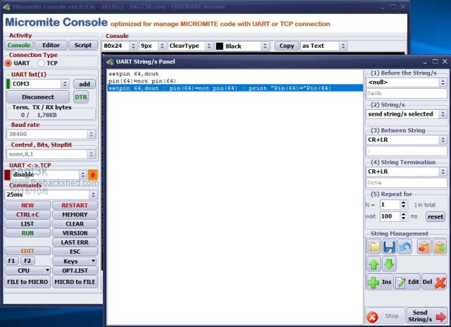

Hi to Everybody
I announce a new version 0.936 of MicromiteConsole:
strings management:
+ added buttons for load and save to file
+ added buttons for import and save to clipboard
+ added undo button
+ possibility to delete multi selected strings
Here the link for download v.0.936
Antonio

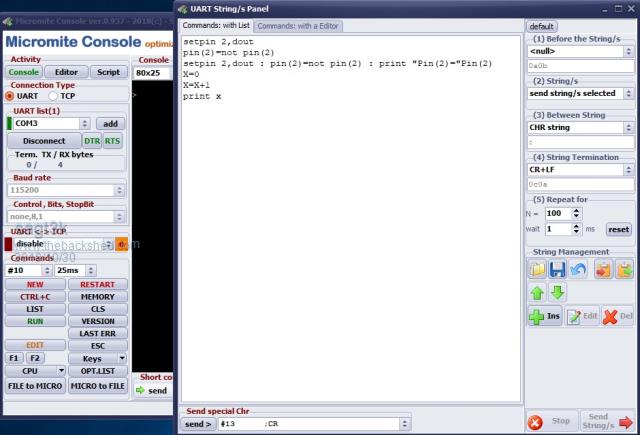

Hi to Everybody
I announce a new version 0.937 of MicromiteConsole:
strings commands management:
+ added "Send special car" in "UART String/s Panel"
+ added button "Default setting" in "UART String/s Panel"
+ now, in "UART String/s Panel" you can manage the commands
list with a mini memo editor
Here the link for download v.0.937
Antonio
