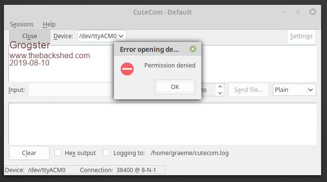

Hi all.
Now I am in Linux full-time, I need a serial-port terminal. Most of my searching results in either Linux terminal softwares(not serial terminal softwares), or Windoze only ones like Tera Term etc.
I want a Linux one.
I did find CuteCom, and installed that, but for some reason, it won't let me talk to the COM port.
If I plug in an E28 module, Linux sees it there at /dev/ttyACM0, but if I select that device and 38k4 baud, 8N1 and try to open it, Linux replies with 'Permission denied'
I know I have the correct path in Linux to the E28 device, but why CuteCom won't let me open the port eludes me at present.
Can anyone here suggest other terminal programs I can try?

Serial ports are off limits to users outside of the "dialout" group. This should fix you:
https://askubuntu.com/questions/210177/serial-port-terminal-cannot-open-dev-ttys0-permission-denied

And yes, you have to add yourself to the dialout group.

@ SimpleSafeName: Thanks very much. I added myself to the dialout group, and I now have access to the MM console.
