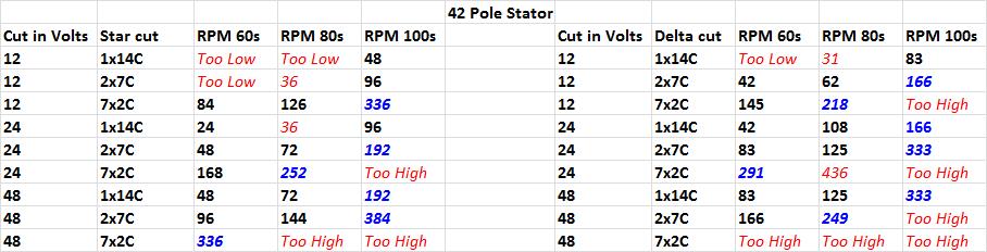

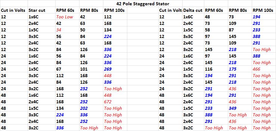

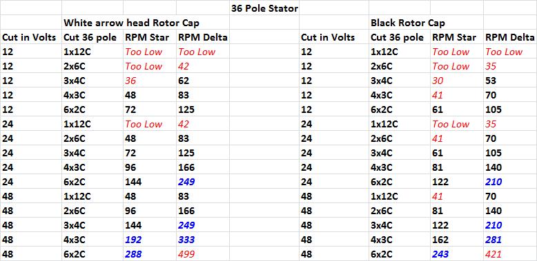

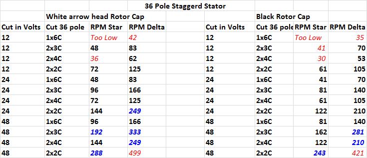

                          | Forum   member David has done some extensive testing of the F&P and put   together the following Cut in Volts vs RPM tables. Using these tables,   you can make a good educated guess on what would be the best rewire   option for your available F&P hardware and system voltage.
 The first table is for the 3 different 42 pole stators (60s, 80s & 100s)
 The Second table is for the 36 pole stator with White arrow head rotor cap and the newer stronger Black rotor cap. Third   and Forth tables are for Staggered stators (both 42 & 36) and are   grouped in pairs. Example on 42 pole stator cuts “1x6C is used with   4x2C”, 1x5C used with 3x3C etc. On a 36 pole stator cuts “1x6C is used   with 3x2C” then 2x4C used with 2x2C. *Please   note where it states "Too Low" refers to RPM below 30 and "Too High" is   above 500 RPM. Too low RPM is most likely to stall the wind turbine   blades at start up. Too High the turbine will likely be freewheeling and   produce little or no power even in high winds. Numbers   in “Blue” need to be used with caution and will very much depend on   blade setup and likely be used as a second “Higher RPM cut in” stator   for say a dual operation. Also they can be halved or divided by 4 for   use with “Cap Multipliers” described by Gordon. http://www.thebackshed.com/windmill/articles/GordonsCapMod.asp   Numbers in “Red” maybe be too low for most blade setups to allow a smooth start up without stalling them. Hope this provides a rough guide to those new to here.
