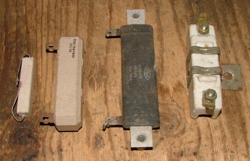

 |  Back to our 1.2 ohm resistor. At 12 volts its soaking up 10 amps, so 12 volts X 10 amps is 120 watts. The resistor needs to dissipate 120 watts of heat into its surroundings. Is 120 watts a lot? That depends on how big the area dissipating the 120 watts is. If its as big as a fry pan, you could put you hand on it and it would  feel warm. If its the size of a grain of salt, it will melt steel and vaporize timber ( this is how a 300 watt laser cutter can cut 3mm steel plate, the energy is focused to a fine point. Ever used a magnifying glass to burn paper?). So as a rule, the bigger the resistor, the more heat ( watts ) it can dissipate. Commercial resistors are designed to dissipate a certain amount of heat. The little resistors in you pocket radio will dissipate 1/4 of a watt, not much, we would need 480 little resistors to dissipate our 120 watts. Fortunately we can get higher wattage resistors.
 From left to right we have a 10 watt, 40 watt, and two 50 watt resistors. The resistor to the far right is a ballast resistor from a car. To dissipate our 120 watts, we could use 3 of the 40 watt resistors, or better still, 3 of the 50 watt resistors, to give us some breathing space.  Its a good idea to have a higher rated resistor then we need because the watts will go up if the voltage goes up. We calculated  the wattage based on 12 volts, but if the source voltage went up to 13 volts, we would need to dissipate 140 watts. While we can use as many high watt resistors as needed, they can get expensive. What cheaper options are there?

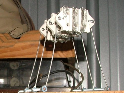

                    | Building your own high watt resistor. The dump resistor below was made from 3 electric jug elements. The wire resistance on each element was 10 ohms, and 10 ohms across 12 volts only draws 1.2 amps.  I unwound the heater wire and cut into 4 even lengths, where were then joined up in parallel before re-winding onto the ceramic insulator. This gave a resistance of 2.5 ohms, which would draw 4.8 amps, at 50 watts. There are 3 elements connected in parallel, so this contraption ended up a 150 watt dump load. It gets very hot, I should have it covered.
