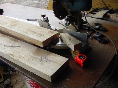

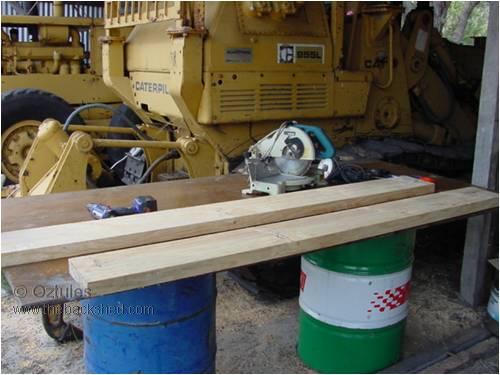

| First.... we get the essentials. A saw, chainsaw, chunk of forest, the power planer and the grinder with flapdisk (this will sort of sand resin soaked wood) and other assorted knick knacs... like a tape measure perhaps.... |
Most other folk will buy properly dried, dressed timber, and select the best at the shop without knots.... I got a chap on the other side of the island to hack some 8x2 pine with instructions to try and get reasonably seasoned knot free stuff.. you don't always get what you ask for over here, but it is wood.... the similarities end there.
Any way, dock the end square: |

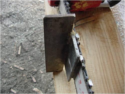

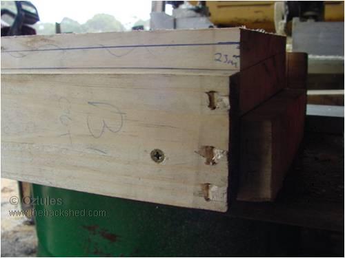

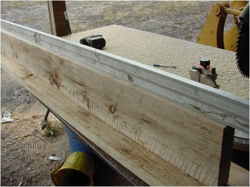

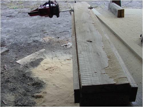

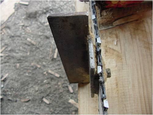

| We need to have made our blade modifications by bolting on two slides to the blade like these: |
I use another 8x2 undressed... so it is slightly wider than the dressed one to use as a base plate to build the jig on.
Grab some straight 3x1" ... mine was from an old packing crate, so I had to true it up first with the planer... it must be straight on the top. It will be screwed to the side of the base plate 8x2 such that it will leave a gap to the top of the blade blank 8x2 that is the equivalent to the cut depth you have made the slides on the blade for... plus how much meat you want to cut off.. It helps to do a dummy cut on some spare 8x2 to establish this measurement...
Note the base board, the blade timber, and the side jig timber: |
Mine was about 8mm. This means that where ever the side timber is, the blade will cut 8mm above this.
IMPORTANT!..............................................
Your chainsaw may be a bit ratty like mine with an old cutter bar and chain. With this in mind, you may do well to leave 2-3mm more meat behind than the proper figures suggest....Mine ... well you can move the chain teeth about 3mm side to side.. so 8mm + 3mm safety=11mm above the cut line..... keep this in mind for the remainder of the story.
It doesn't look it, but the line is the same all the way, so the blade will just graze the 8x2 on this side.. and yes it's raining yippee!!....
Hee hee... just graze... not really. In my case, the wood is rough cut and not straight... so I will be gnawing into the face a few extra mm to get a true straight /flat face... ie I can't rely on the wood to be true.... especially three times in a row. Some will be 52mm, some 48mm and some 50mm. So I will be removing more than is traditional for the face. Normally the leading edge will be the top corner edge of the timber. |

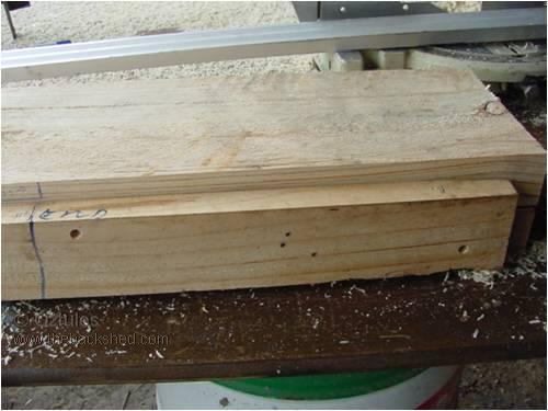

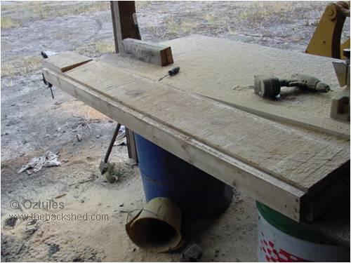

Now for the other sides timber to guide the slide on the chain saw.
Here, we guess how much angle we want. I wanted the tip to drop across the 8" by about 10mm. I don't know how many degrees that is, nor do I care, but it felt about right. I hadn't really decided on the tip width yet
That being the case, and pruning that extra bit we talked of, the easiest way to define the guide top is ... same as the other side, less 10mm.... whatever that turns out to be. (ignore the scribble on the wood) |
Now this line drops to twice the 10mm drop at the hub end. Note Hub end for me is 400mm out from the actual end of the blade. So I should say 400mm in from the hub end, we want the guide to be 20mm lower than the leading edge side.
I start the profile about 400mm in from the hub end. This gives plenty of meat to mount the thing, and the power available.. despite the outlandish blade calculator sizes here.... is pitiful, and not worth chasing.
Go for strength .. it pays bigger dividends. So, the blade profile part makes up only the outer 1.6m of the 2m length.

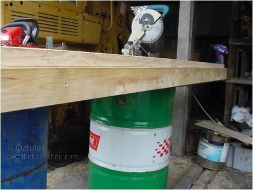

It will look like tapered like this:... so you can now screw on the second side guide. (10 mm lower at the tip end than the leading edge side, and 20 mm lower at the 400mm in from the hub end. |

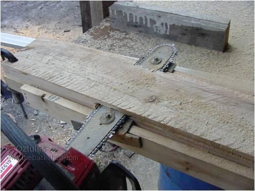

Now, we want to stabilise the blank in the jig. I just use some long wood screws, and screw the jig to the blade blank. I use 2 on the leading edge side (one each end) and one on the trailing edge (second guide we put on) in the center.
This is better than clamping it down, as it holds it in space/suspension, rather than relying on the timber to be straight or the three blanks to be of equal thickness. After the first cut it won't matter as we will have effectively thickness-ed it anyway.

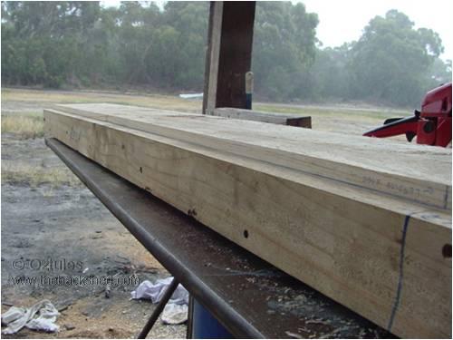

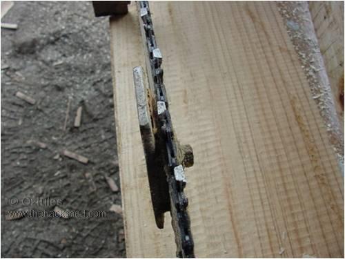

Ok, were ready to fire up the chainsaw and go for it. It is simple, place the saw slides on the guides, and go. For these blades in radiata pine, it takes about 3 mins to do the whole 1.6m. Use sharp blades, well tensioned or they will wiggle around a bit and take out more than you expect.
AGAIN:
The chain links inners can wobble about in the cutter bar guides. A new cutter bar and blade would be nice. These have done 4 years of fire wood, so you may like to offset your calculations by a few mm of insurance to allow for poor blade performance.

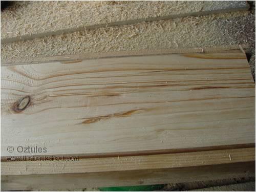

So 3 mins later we have made the leading face of the blade like this: |
| and this at the 400mm end point (hub end) |
| or looking at our work so far.... like this: |

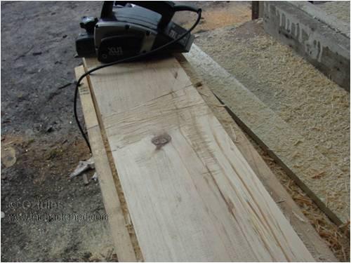

| About 3 minutes with the planer and we can get this. It is quick because it is a flat face for our purposes. |
| and the hub end will be like this: Notice the drop off is planed as well... by going across the grain.. tut tut. |

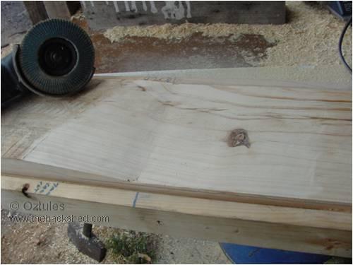

| and a good 30 seconds with the flap disc grinder, and we are virtually there. You can see once you have the jig, it is only a ten minute job to do half a blade... not bad. |
