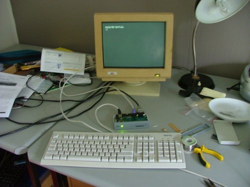

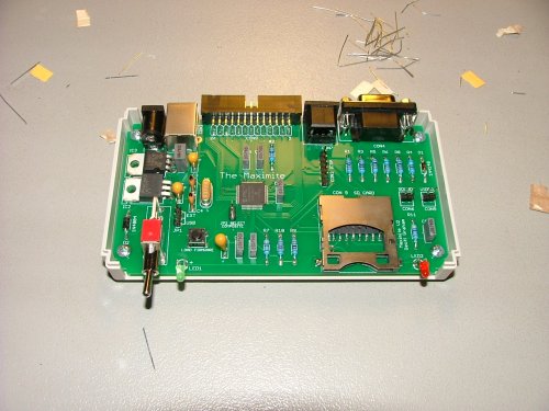

Since its so new, at the time of writing, stocks are limited, and there is a back order of several hundred. Hopefully the next few months will see this backlog cleared. I bought my Maximite from MicroZed Computers for $79.95, plus $10 delivery, which was overnight in my case. The kit quality was very good, includes all parts, and the microchip is already soldered into place ( thank goodness ).
Assembly took about an hour. You need a fine tipped iron and a good eye. Most joins were straight forward to solder together, but the SD card holder needed a steady hand. If you have assembled a few circuit boards before, you should be OK with this one. |
First power up, Yippee!

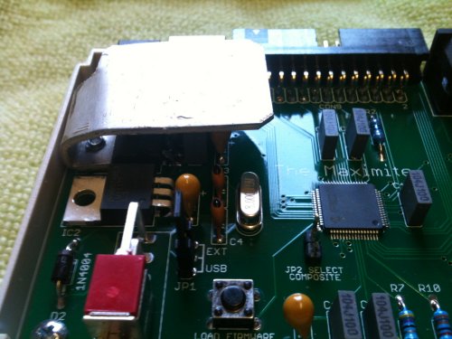

I then added a heat sink to the LM7805 regulator, its a recommended addition if you intend to run the Maximite on 12volts or more. Be careful here, the LM1117 regulator next door has a metal tab at 3.3 volts, where the LM7805 is at ground ( 0 volts ), so you need to make sure they aren't shorted together with the heat sink. I only fitted the heat sink to the LM7805, so it wasn't a problem. The LM1117 regulator runs cool without a heat sink.

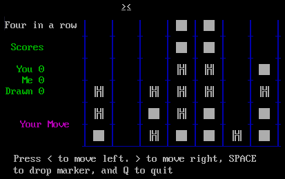

With the Maximite up and running, it was time to refresh my memory on old school BASIC programming. I have a old favourite program from my Microbee days, back in the 80's, called Four Row. Its a Connect Four clone, and you play against the computer. I found the game on a Microbee demo tape, and remember spending hours playing it. I don't know who the original author is, shame, I would like to give them credit.
Back in the 90's I ran a BBS ( pre-internet computer system for sharing files over the phone ), and wanted to add a few games playable online. I ported the Four Row game over to GWBasic, and later QBasic, to run on the BBS. Instead of displaying the game on the screen, it sent the graphics out the serial port using ANSII characters.
So to cut my teeth on the Maximite, I ported Four Row to MMBasic. Took a few hours to get it working right, and I learned about a few differences in some of the commands between QBasic and MMBasic. This version of Four Row uses the Maximite's graphics and sound features. Below is a screen shot of the working Four Row on the Maximite computer.
You can download a copy of Four Row here, and Geoff has been kind enough to include a copy with the latest Maximite Library ( a collection of user written programs ). Its a tiny 3k file. I should add, its not an example of good programming, its been hacked and patched many times over the years. But it does play a good game, you can almost see the computer thinking about its next move! |

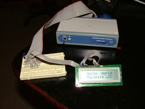

One of the sample programs you can download for the Maximite is a LCD driver. It uses the common 16*2 LCD screens, and 6 of the Maximites output pins. At first I couldn't get it to work correctly, but Talbit from the forum came to the rescue, suggesting I add a small delay after the LCD initialisation code. Fixed it.
