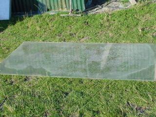

In this case we will be using the iron free solar glass from a disused solar hot water panel. It is toughened, and the iron free...... this means when you should get 1.8w per cell you will. If you use window glass, then it will be less, but work anyway.
So we get the glass and wash it in water and dry thoroughly. Then wash the cell side with methylated spirits and dry. My glass has prisms on one side and flat on the other.... like frosted shower glass almost.... I have tried bot the rough side and the smooth side to put the cells on..... I think I prefer the smooth side and get a rough outside..... slightly better when the light is diffuse....... however, in latitudes where the panels are flatter, then cleaning becomes a problem where the dust settles in the rough valleys.... so in those latitudes, perhaps put the cells on the rough side with the smooth side to the sun.... your choice really.
My glass looked like this:

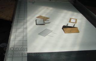

I also use the solar hot water case as a straight edge to build the string in. I use transformer paper on top of the aluminium (to stop the Al draining the heat from the cell too fast when soldering), and use the side of the case as the straight edge. This way guarantees that the cells don't wander about the place.
It looks like this:

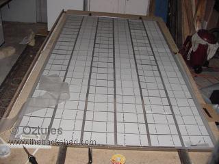

We then carefully (very) pick it up and transfer it to the glass sheet which has the EVA cut to size on it I use some untabbed cells to get the spacial arrangement to make it look symmetrical …...not very well really, but I did try a little bit.

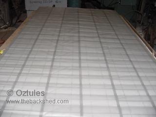

We keep labouring away until we fill the glass up with cell strings. We then need to place the bus lines in to join the strings. There was not a lot of room to do this here, so I actually placed the output tabs on top of the last cells in the string in some places. I use transformer paper to effect the isolation needed, and EVA strips between any surfaces, so that the whole lot will melt together later. It may be seen here:
From a "looks" point of view, it is more important to get the strings straight, and the gap between strings even. The inter cell gaps in a single string seem to have little impact visually compared to these other two requirements. I see a lot of youtube folks with tile spacers to try to get it right, and they still fail miserably.... so just keep the lines straight, and even between strings and it will look ok. .... I think anyway.

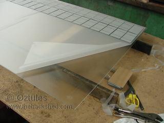

Then it's time to place your second sheet of EVA on the pile. Hopefully you remember to cut it before we get to this point.... unlike me.

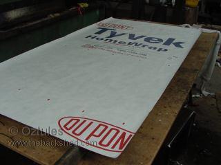

Then it's time for the backing material (building wrap this time for me, later I will use plastic sheet (ran out of the white stuff), and whatever else for you).
