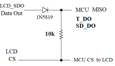

If you look back through the various ILI9488 threads you will see that the ILI9488 chip has a fault in the silicon that prevents the SDO-(MISO) pin switching off when CS is high. Instead it stays active low, preventing touch and SD cards from using MISO. To get touch working just put a 680R from SDO-(MISO) to your MCU MISO. This may also  allow SD cards to work, but not always. If you have SD issues try this:-
I have found it passes all tests.
Read this thread:- https://www.thebackshed.com/forum/ViewTopic.php?FID=16&TID=15214#192349
