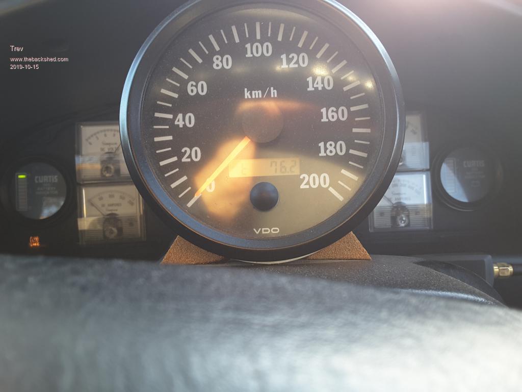

I left home, Kuttabul Qld,  at 4.38am. Met up with Glen George at Mackay at 5.30am.

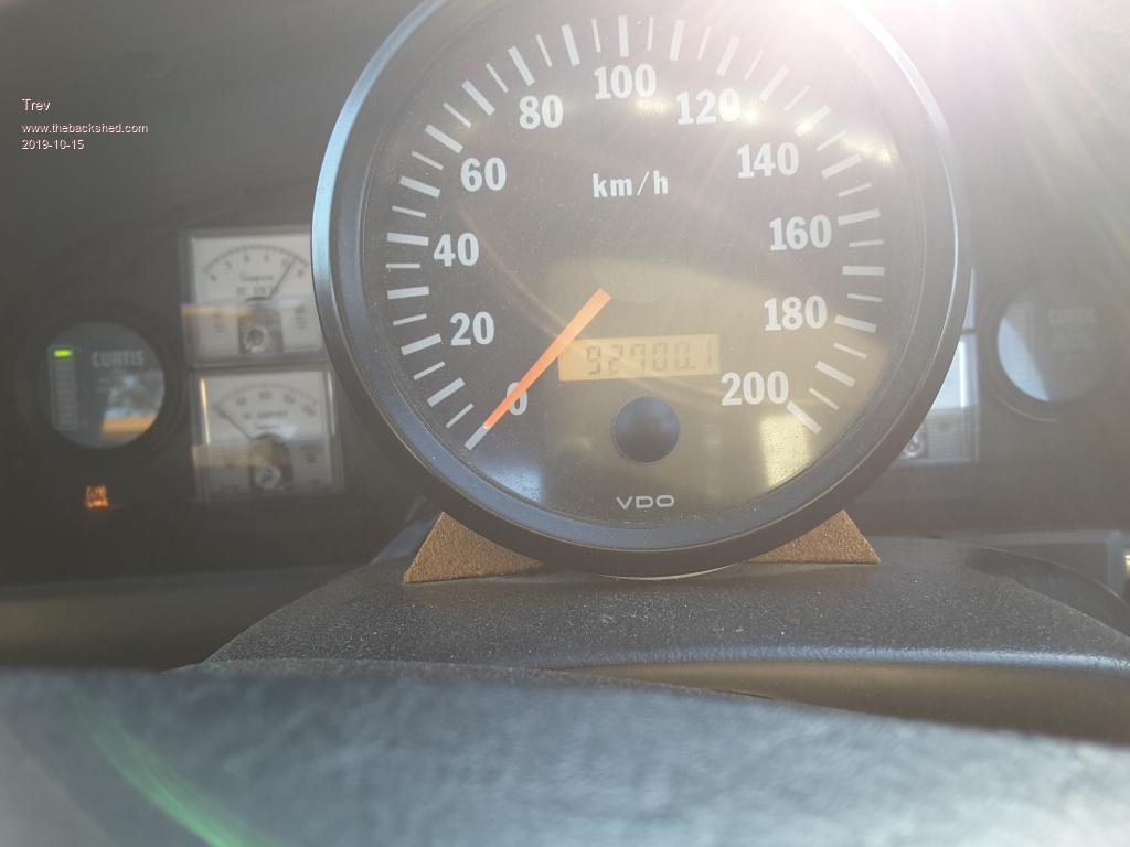

Drive to Sarina. Forgot to photo the speedo reading at home. In Sarina trip meter which zero at home, shows 76.2km and main reading shows 92700.1km. So speedo reading at home would have been 92623.9km

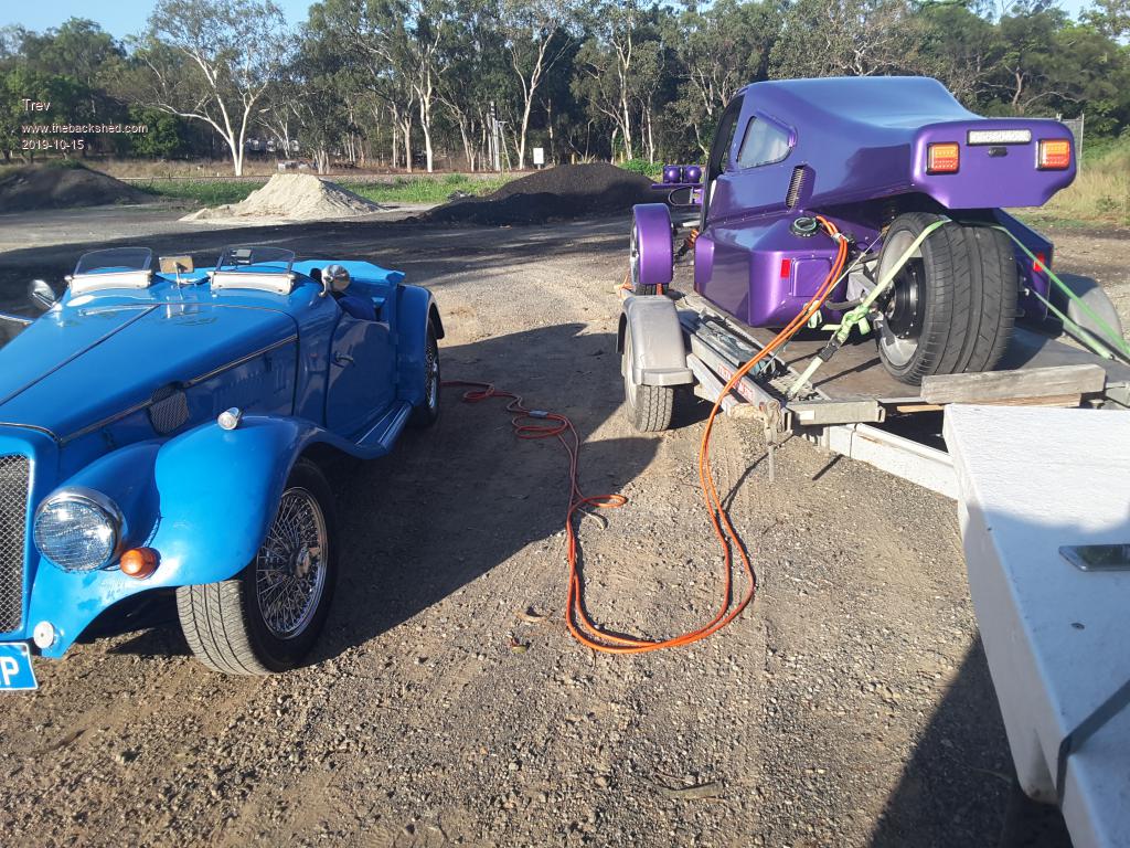

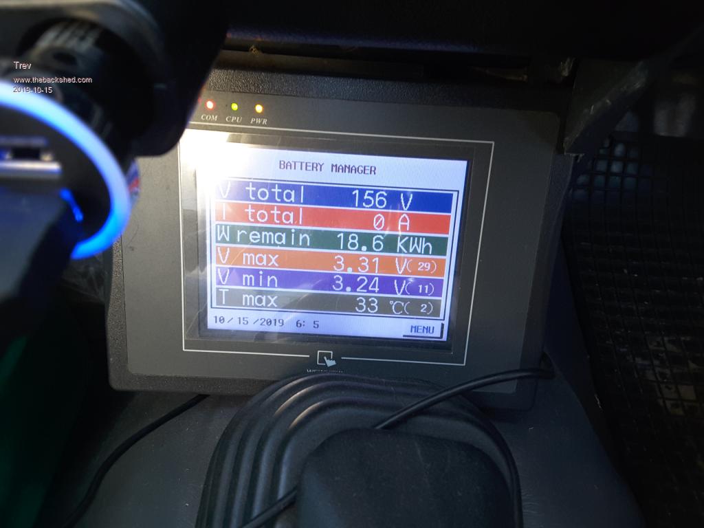

Dumping power from T-Rev to MGEV 9.15am. After MGEV, I will connect it up to dump to EV Hilux. EV Hilux used 18.6kW to drive the 76.2km. That's 4.1km /kW x 26kW = 106km range.
