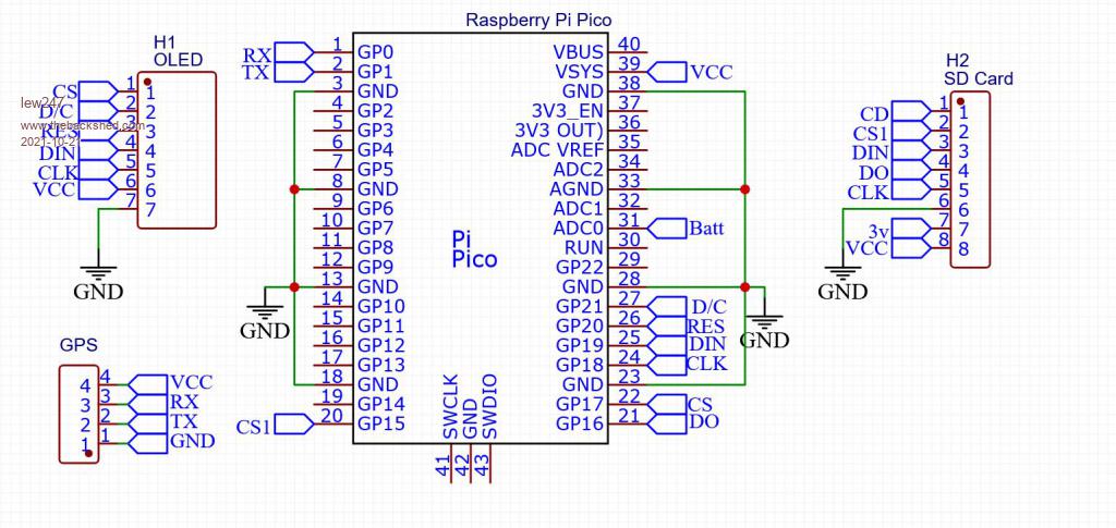

Just trying to get my head round the Pico
I've had one since the day they were released but only just started playing
I cannot get the config right, I'm pretty sure I know how to get Com1 configured but thats for once I've got the display and sd card working
can anyone tell me what I'm doing wrong please? and how to config them properly?
I'm reading the manual and trying for several hours but can't see my mistake
OPTION LCDPANEL SSD1331, OR, DC, RESET, CS
Initialises a colour OLED display using the SSD1331 controller. This supports 96 * 64 resolution.
> option system spi gp18,gp19,gp16
> option sdcard gp15   'this SHOULD work???
> option lcdpanel L, gp21,gp20,gp17
Error : Syntax
