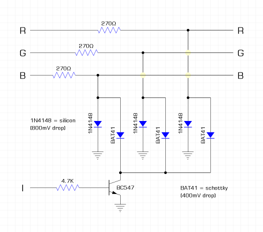

someone might care to give this a try, digital RGBI to analog RGB:
note - the function of I is inverted
i have NOT tried the circuit, but believe it should give good results. but, of course, will not solve the problem with loading images. perhaps an OPTION could be added to the firmware to select between RGGB and RGBI. this option could also, at the same time, switch between two sets of colour constant names.
