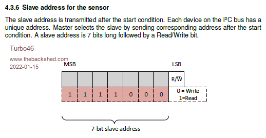

Posted: 09:41pm 14 Jan 2022
From the data sheet the extra bit is the LSB '1' for read.
  Quote  A slave address is 7 bits long followed by a Read/Write bit.
Bill

Posted: 10:19pm 14 Jan 2022
This tells me 7 bit plus LSB. I still read it as &HF1.
Am I mis-reading it somehow?
Bill

Posted: 10:43pm 14 Jan 2022
OK, it's a seven bit ADDRESS followed by a '1' bit for 'read'. Does that mean that you DON'T send it '11110001' to issue a read command for that address?
Bill
Posts: 7815
Posted: 10:47pm 14 Jan 2022
Yes, you do. You are then supposed to tag on the *actual* 10-bit address.

Posted: 10:58pm 14 Jan 2022
Thanks, reading Jim's quote from the manual shows I need to read up on the subject a bit more. Sorry if I added to any confusion.
