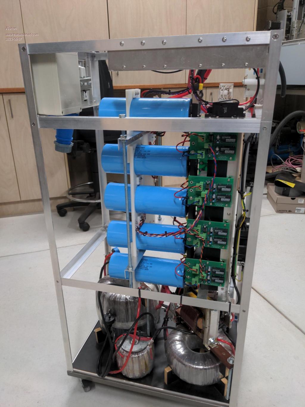

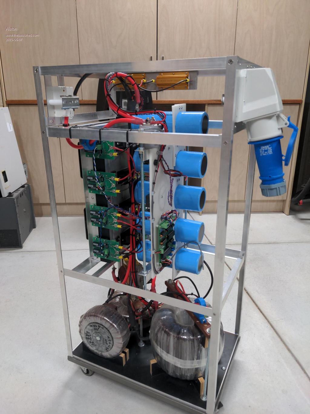

Got most of the wiring done now, yet to test it with the capacitors in place as I had to get the pre charge side of things sorted first. The space above the Warpinverter PCB will have the control PCB. I have a pre charge relay with it's NC contacted wired to a discharge resistor so when that is shut off the caps will discharge. Tony mentioned ages ago he was having failures with his pre charge resistor due to thermal shock but after going with a very oversized one he hasn't had that, hence the large 200watt ones you can see in my photos.
