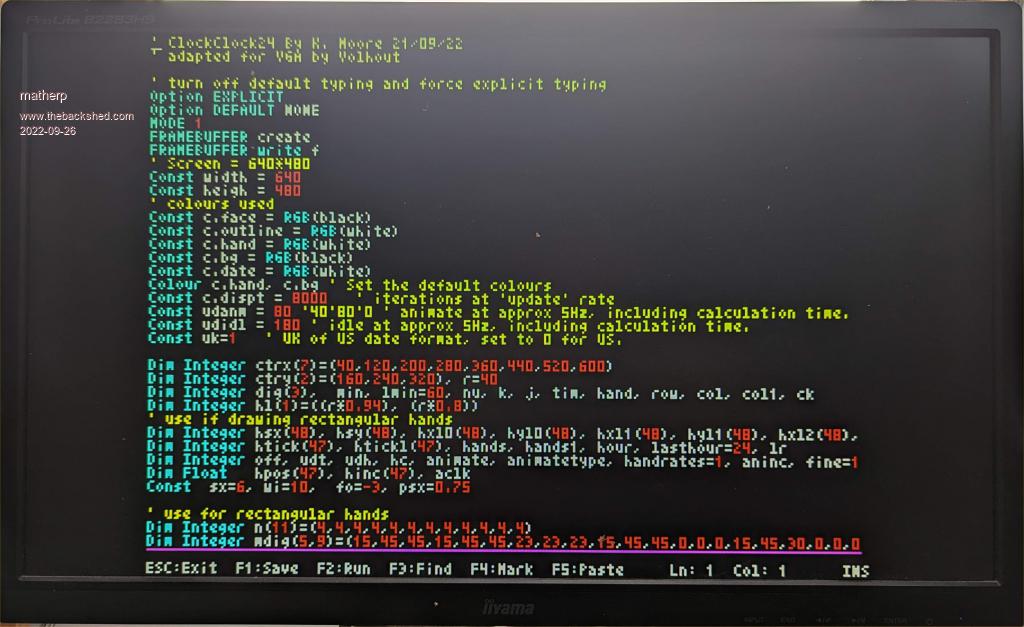

The default font after switching to mode 2 in a program is 7 (8x6).
HOWEVER when you go back to the command line the system automatically defaults to the "default font" as set by OPTION DEFAULT MODE (1 or 7) unless overridden by OPTION LCDPANEL CONSOLE font.
So, if you go "MODE 2:?MM.FONTHEIGHT" you will get 8.
However, if you do this as two lines you will get whatever has been set in the the most recent of OPTION DEFAULT MODE or OPTION LCDPANEL command
The idea of this is so you can set the font for the command prompt and either operate with a small font in mode 2 if you wish (gives colour editing), or use a bigger font as the default in mode 1 to help with accessibility issues
OPTION DEFAULT MODE 2 ' defaults command line font to 7
OPTION LCDPANEL CONSOLE 8 'make it really small (6x4)
OPTION COLOURCODE ON
Mode 2, font 8, 80 chars wide
I know this is somewhat odd/difficult but it is what it is
