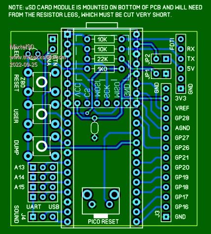

Z80 Emulator...in a matchbox (6809 as well, apparently)
Posts: 7889
Posted: 07:01pm 24 Sep 2022
Erm.... the decorating (and several other things) got put to one side a bit...
He said, guiltily.
48mm x 50mm using a standard Pico and no SMD parts (it's the usual uSD module with its own pullups and supply decoupling capacitor that I've used previously). The GPIO header is identical.
Slight changes:
Power is via VSYS rather than VBUS if powered from a serial port. GP22 is via a "buttons enable" link rather than hard wired on the pcb.
EDIT:
Decided it was a little plump, so some slimming exercises have brought it down to a lithe 43mm x 50mm.
