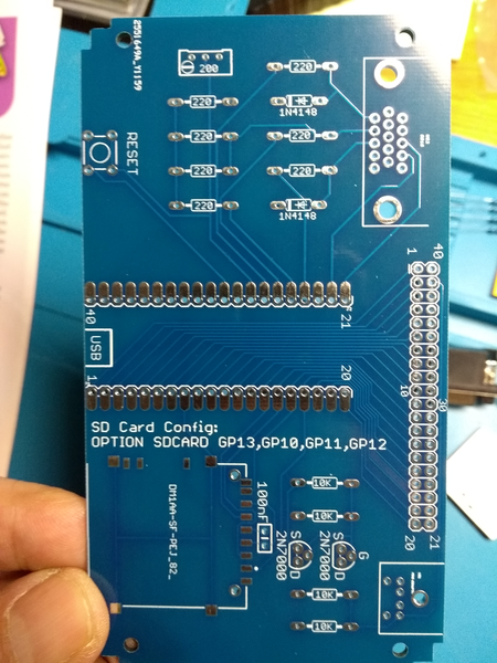

@andreas where can i find the pcb from your Picomite?

  Plasmamac said  @andreas where can i find the pcb from your Picomite?
Hi Plasma, do you mean this one?
This is from Silicon Chip magazin July 22 VGA PicoMite ($5) or Kit ($35).
-andreas
