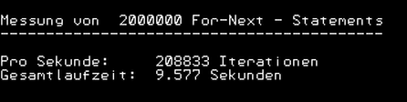

Using the same code on the PicoMiteVGA (simply by using the same sd-card) I get improved values:
By comparing the old benchmark code to the current code there is one major difference: In the new faster code I did declare the control variable as integer before use within the for..next construct.
Result: Declaring control variables before use results in huge speed-up!
Example:
CONST Maxloop = 10000000
DIM i AS INTEGER = 0        ' gives huge speed-up
FOR i = 1 to Maxloop
 'Do_something
NEXT                        ' do not write i after NEXT
It seem to be very important not to write down the control variable after the next-statement.
Writing: for i = 1 to Maxloop : next
is much faster than
writing: for i = 1 to Maxloop : next i

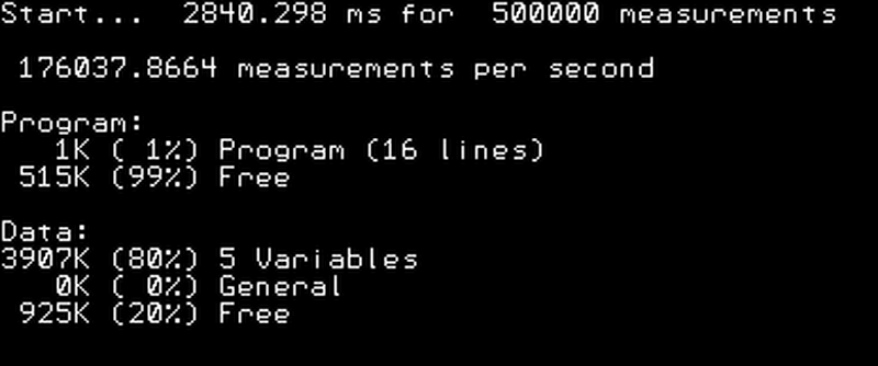

Doing real measurements on the cmm2 within the for..next loop:
' bench.bas - how fast can you measure
const maxmeasure = 500000 ' number of measurements
cls
dim mess(maxmeasure) as integer
dim i as integer = 0
setpin 33,din ' digital input on pin 33
print "Start... ";
t1 = timer
for i = 1 to maxmeasure: mess(i) = pin(33):next
diff=timer-t1
print diff;" ms for ";maxmeasure;" measurements"
print
print (maxmeasure/diff)*1000;" measurements per second"
print
memory
save image "camac.bmp"
