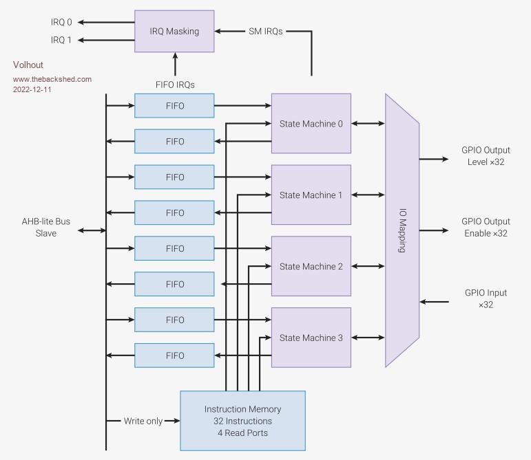

Block diagram of a PIO: the 4 state machines and the FIFO's are shown. As is the access to the IO.
There is much documentation in the RP2040 datasheet (whole of chapter 3) on the PIO, that I often consult. You can find the datasheet on the Raspberry Pi web page.
The RP2040 has 2 PIO blocks (so in total 8 state machines) but we will only experiment with PIO block 1, since PIO block 0 is used for generating VGA video in the VGA picomite ("boot to basic computer" on Geoff's website). And the VGA picomite is a perfect platform to learn through execersize.

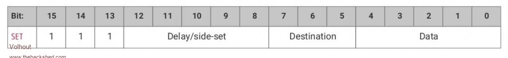

The state machines have a SET instruction:
The instruction can SET up to 5 bits (the DATA field) in multiple destinations (DESTINATION field). One of them being the IO pins (DESTINATION = 000). The DELAY/SIDE SET field will be ignored for now (value 00000). More information about the SET instruction can be found in the RP2040 datasheet (chapter 3.4.10), which I highly recomend reading.
So the instruction will read 111 00000 000 DATA
Since we have 1 IO pin configured we can fill DATA with either 00000 (set pin to 0) or 00001 (set pin to 1). The other bits have no function with our configuration. In case we woudl assigne 2 IO pins, as hinted above, we could write 2 pins with 00000, 00010, 00001, 00011.
Our program takes shape...
111 00000 000 00001  = 1110 0000 0000 0001 = &hE001  SET PIN HIGH
111 00000 000 00000  = 1110 0000 0000 0000 = &hE000  SET PIN LOW
What about setting the pin to output mode... We use the same command. Only the DESTINATION field must be 100 to set the PIN DIRECTION to 1
