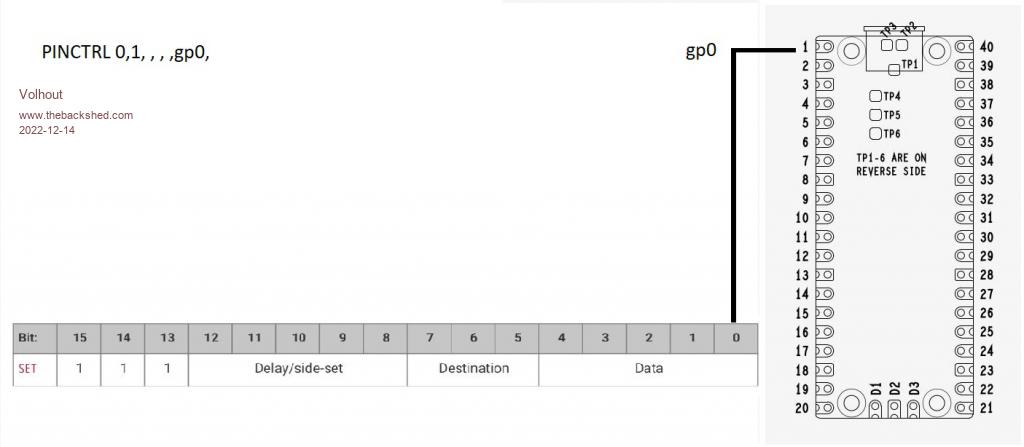

- explaining the exercise with pin configurations
Last chapters exercise was about moving the 666Hz tone from pin GP0 to GP2.
You did not need to change the actual program, but only the configuration.

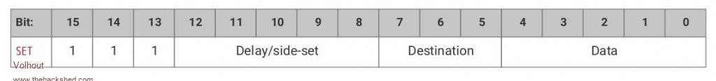

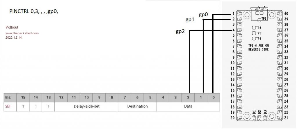

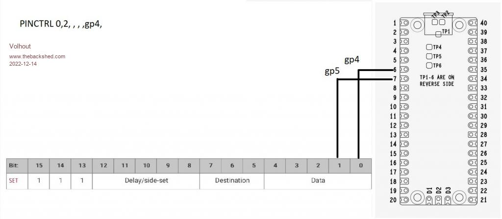

The starting point was the GP0 configuration, that links GP0 to bit 0 of the SET command.
You can assign more pins to the SET command by increasing the number of successive pins
Or different pins, by selecting a different starting point
Knowing this the simplest answer is to assign 1 pin, named GP2.
