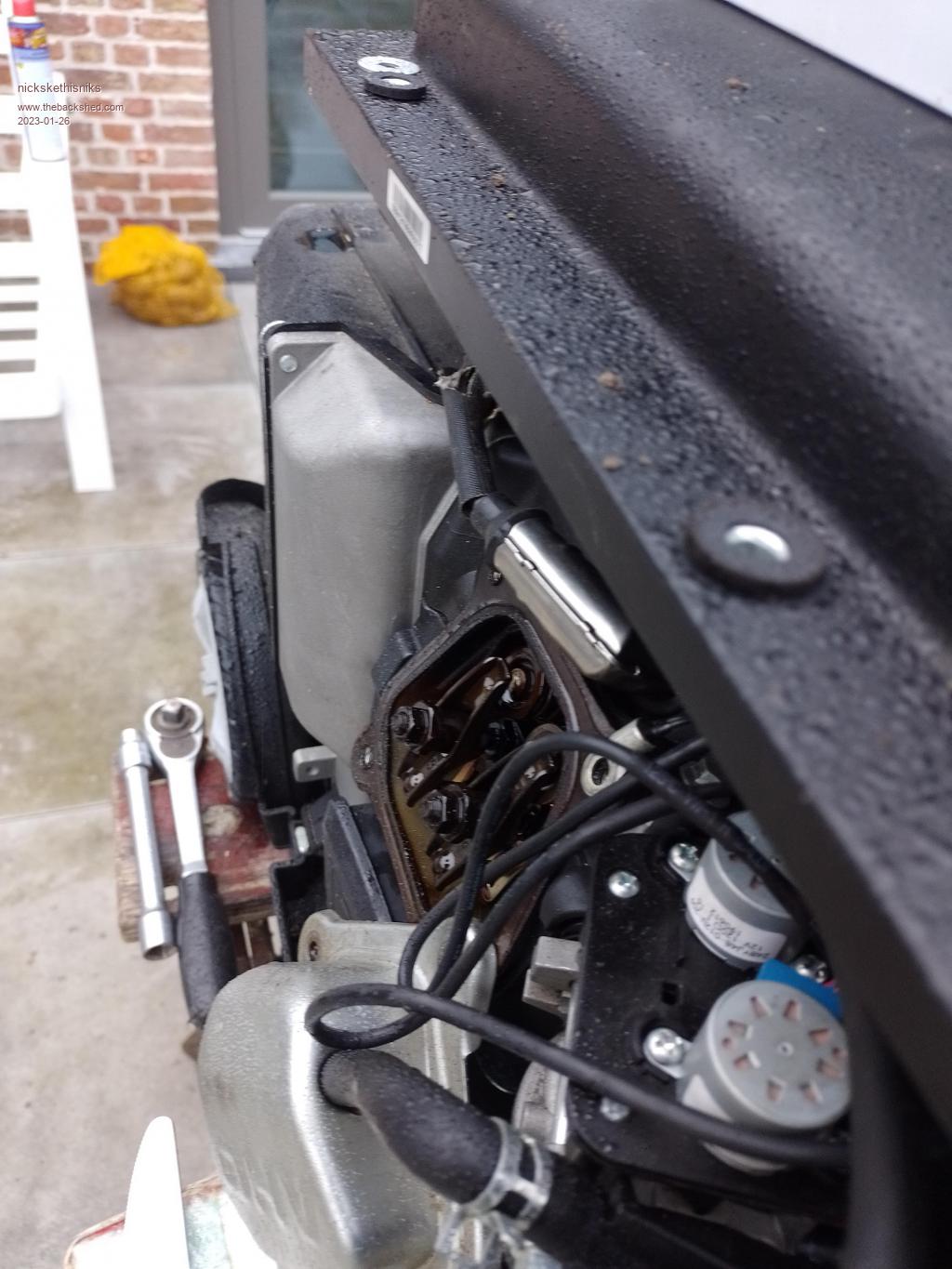

So I might found a problem, I checked the valves again during start up:
Something is stuck: sometimes it's normal but mostly not, so I assume one of the valves is not working correctly this way...
Can I assume this can be a major failure since it's not coming up?
I will try to upload a video.
Edit:
Ok, so I tried to move it a little bit by a soft hammer, but it's not moving fluently, I can move the small piston but it's going smoothly like the other one, the spring can't move the small piston by it's own.
What can/should I do next? Is it a lost cause?
Taking it all apart and then see further?
