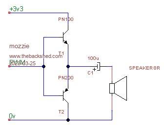

If the original question is the simplest / low cost / minimal approach to driving a small low cost / quality speaker from a Pico then a simple push / pull emitter follower with output cap works fine here
Yes its LO-FI
Yes there is a little hiss
Yes it may be outputting 44khz (but I cant hear it)
Yes the output is only about 2v p-p @ 40khz and the audio is below that
But it is simple
Lyle.
P.S. Just found Phil99's original post and that is an elegant solution:
https://www.thebackshed.com/forum/ViewTopic.php?TID=15362&P=3#194596#194596
with only a couple of extra components.
