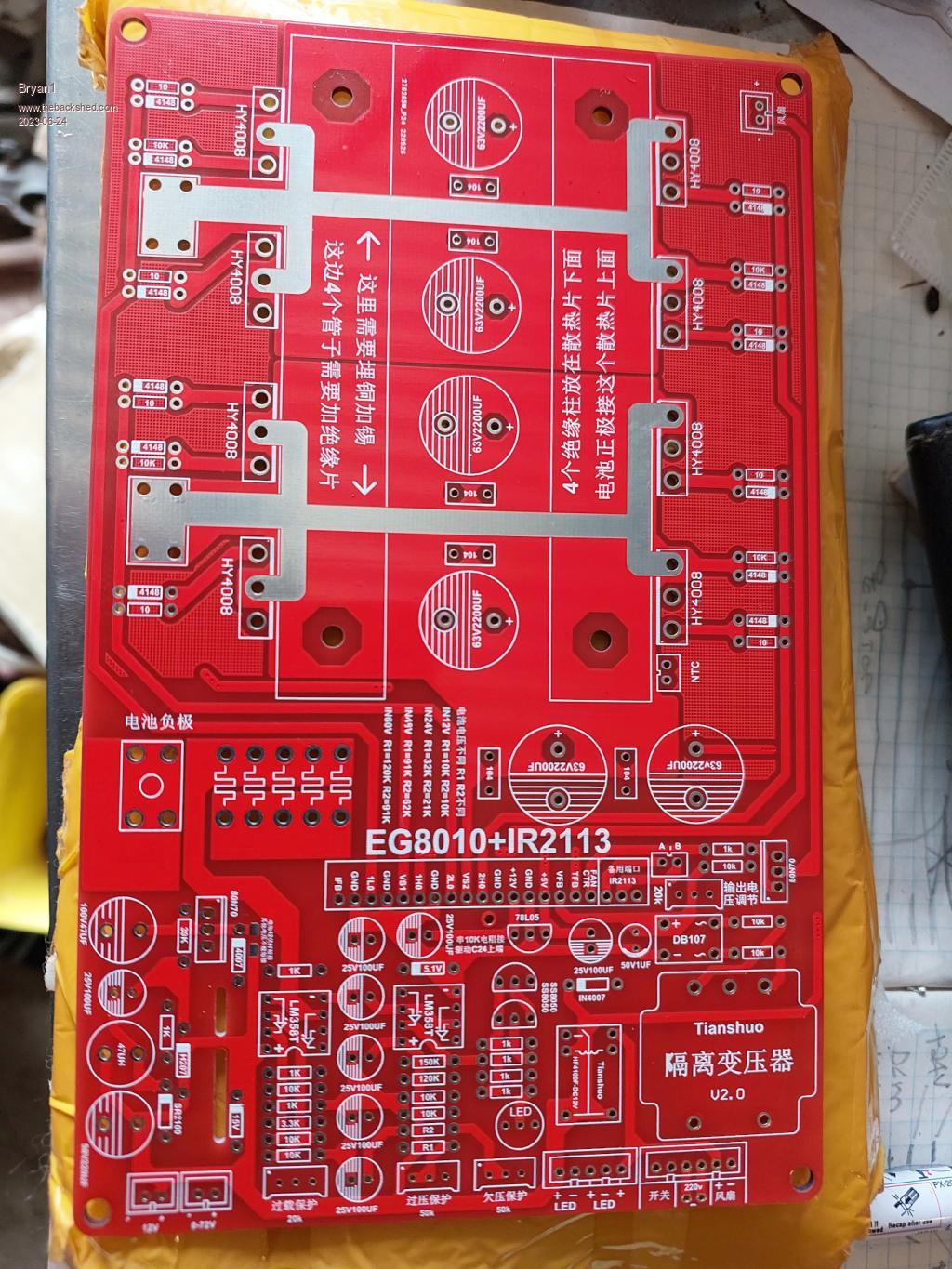

Now as I'm on a lean budget as work aint very much I've decided to build up that ching board I got ages ago.
I do have those HY5608 360 amp fets here to use so the fets should get the best out of that 3Kw areosharp toriod. I do have a fair bit of 18sq.mm cable here so I'm going how many turns I can get inhand to fit in the centre of the toriod, I will be going with 12 turns for 24 volts.

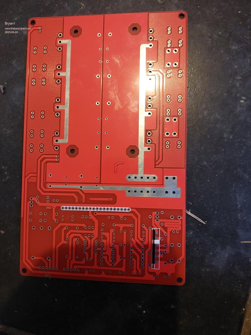

Also I don't trust those power pcb tracks on the board so I'll put some copper wire on the tracks and solder them on so the current can flow as it needs.

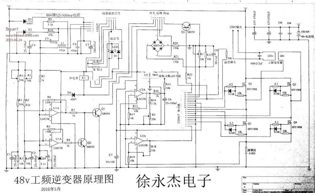

Poida put up this schematic which I've been comparing with the circuit board and it is a close match.
For me understanding what the LM358's are actually doing will go along on my journey to understanding the big picture. Now those step down DC boards that fit vertical on the pcb I still need to find a source and knowing what the step down on the feedback  5 pin transformer.
