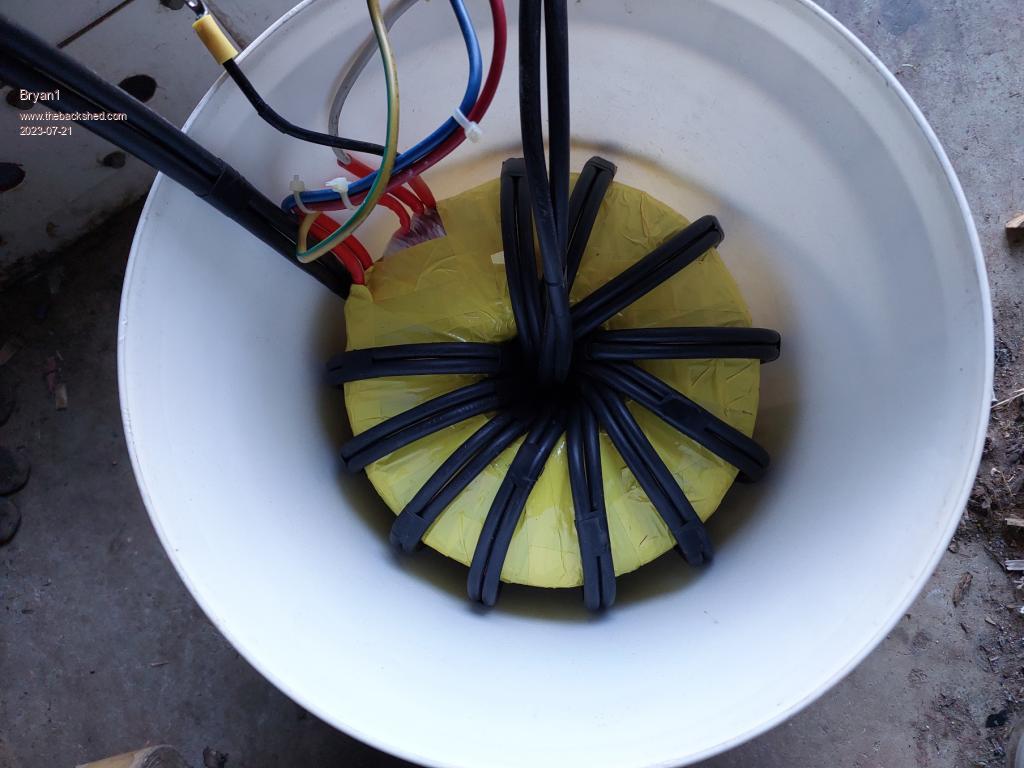

Thanks for that mate and yes I did learn on joining that blown fet club with my MTTP failed build.
So this morning taped the wires together and wound the toriod with 11 turns.
So we now have a toroid in a bucket   I do have a couple of drums of Dow Corning Dielectric Tough Gel and as I did get it back in '08 today I finally opened them up and did a trial run to see if this stuff will still set. Well after 6 hours it is starting to set and hopefully in the morning it will be set.
Then I'll pot the toriod in the bucket then after it is set cut the bucket down to the height then I can bend up some flat bar for clamping the unit.
