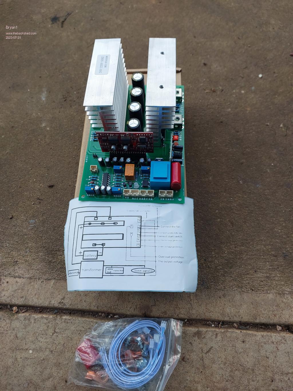

G'Day Guy's, Here is pic of the inverter
Now with schematic paper shown it is showing the inductor only on one leg to the toriod where I did read putting one on each side was the go. I do have that large aerosharp choke where I wound 10 turns on each side to use so I will go with it.
Also I have a couple of those small display boards that connect to the egs8010 board so I'll solder on the header then I can have a display to use to set the pots.
Now to left of driver board is a jumper just labelled "J" and one side goes to IFB and on reading the datasheet it should be in place so IFB is tied to ground if my thinking is right.
