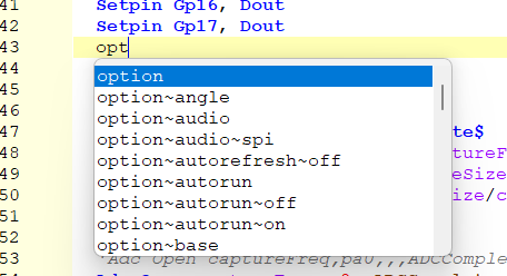

The syntax files are now back to one file for keywords and parameters. They also now have a section for phrases.
This means that auto-completion can have a lot more options for you to choose.
If you don't like auto-completion, you have the option to turn it off.
The ~ character gets replaced with a space when it is inserted into your code.
