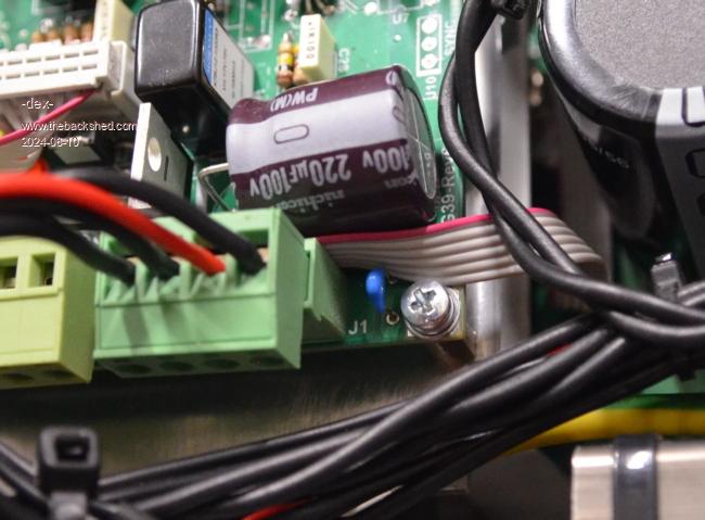

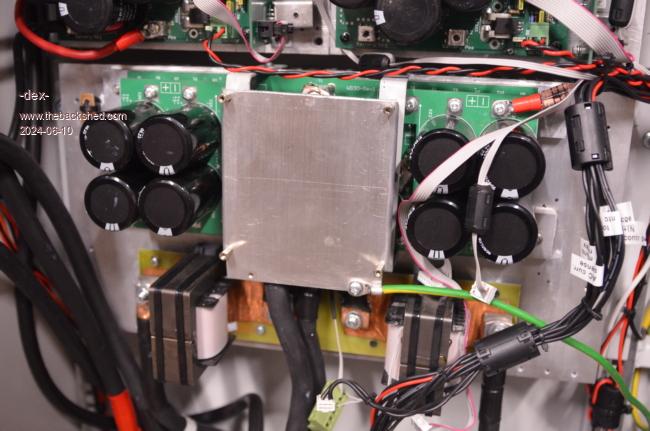

I did what was suggested. The aluminum plate was connected to earth bus and a 10nF/100V MLCC capacitor was added

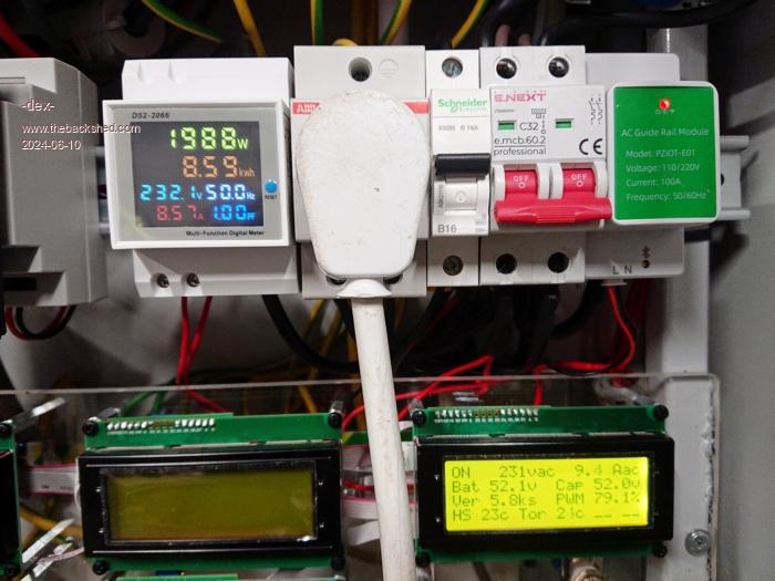

And now the good news - with the same load there is now no voltage drop!!!
With this resistive load (the same ~2kW kettle, also used previously), it increased the AC voltage even slightly, and the % SPWM change was also visible.
I probably need to put even more load in there now before I open the bubbles, but at this point feel how much I'm shaking your hand in gratitude for your help Mike!

That is great news Dex, to be honest I woke up after a very sleepless night with a sense of dread, thinking what if it does not fix the issue, now what.  You see after I posted, that I could account for maybe a 1.8% change not 7.2% I went to the workshop and started my inverter and tried to inject noise into both input pins of the opamps U1A & B and U2B. The only pin that I could make a small change with was U1B pin6.
But I even got a clip lead and coupled capacitors direct from the switching node before the chokes using 2.7pf all the way up in small increments to 100pf but I could not cause the amount of change you were experiencing.  In hind sight my inverter was unloaded whilst I was doing all this so it wasn't exactly the same test I suppose - that was when I started doubting myself.
I don't want to boast but when you bought those boards for the inverter you also bought 40 odd years of experience and cunning with it, I consider analysing servo loops and noise injection and curing issues with them to be two of my specialties.  I have fixed some amazing things in my career that other engineers gave up on, sometimes just shifting a wire to a different point on the same track solved problems.  The secret is turning differential noise into common mode noise and the problems magically vanish, all the way up to RF.
The provision of the pads for the 10n cap insertion was my typical belts and braces approach is it possible this may be required ? - better to have it and not need it than the other way around.
Anyway thanks for working with me and happy invertering ! I have a confession I did the drawing in a hurry with my mouse using microsoft paint and the mouse freehand. It reminded me of trying to use an etch O sketch if you know what that is lol but I was otherwise engaged and had no time

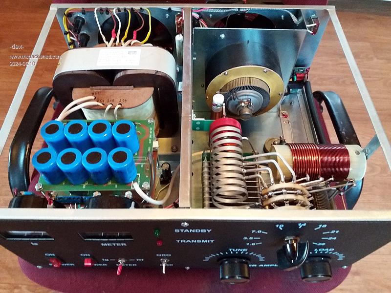

You need to try using a noise injector like mine in the photo below
Just kidding, I haven't done it this way with these lamps, but someday I will make such tests and I hope that the inverter will remain insensitive to the advances of strong radio waves.

That sure is a scary looking piece of equipment  - I think I will stick to inverters.
Is that a type of magnetron ? It sure is a complicated looking pie warmer. Is that actually MHz on the tuning scale?
