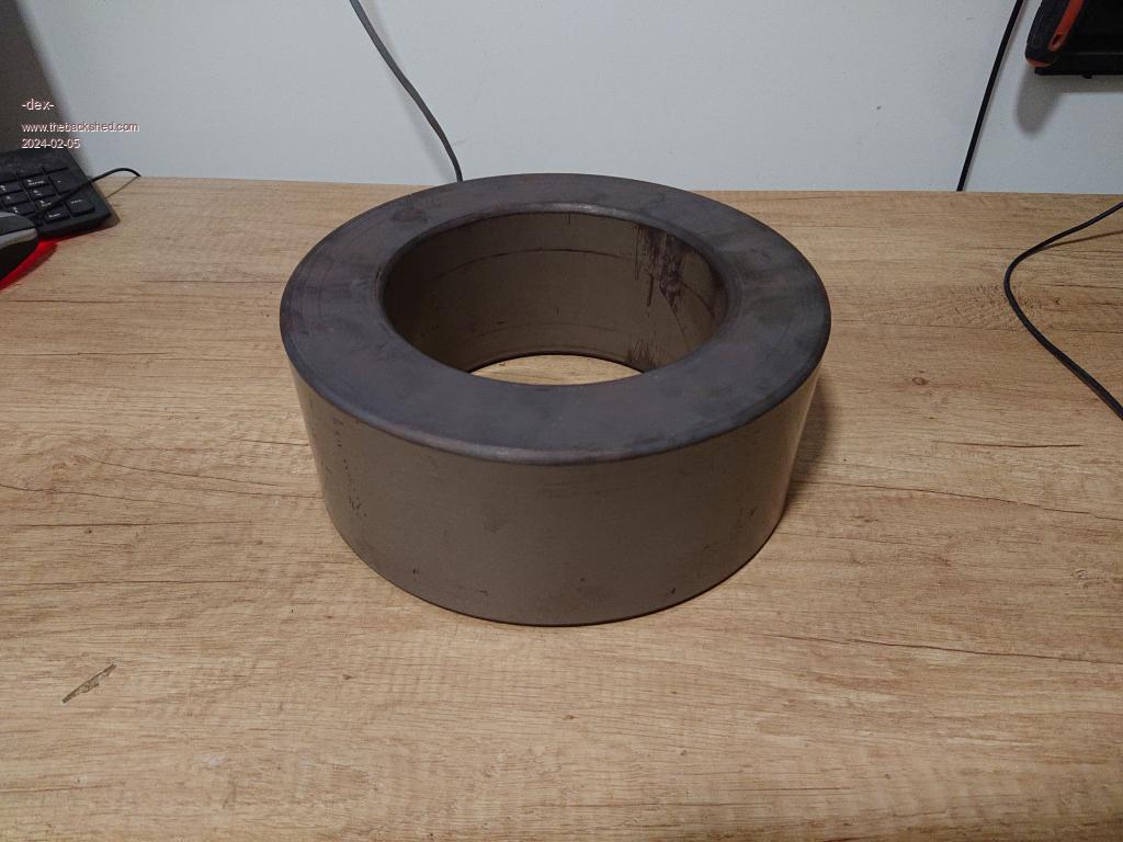

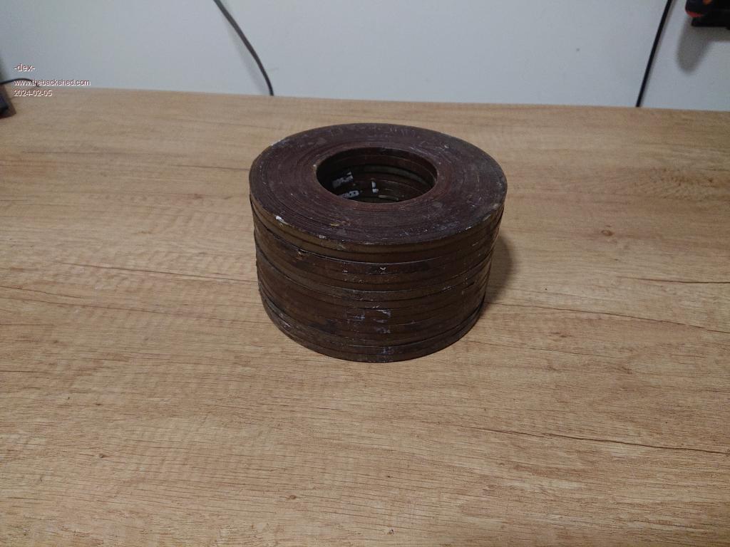

The big challenge is to get a steel core for a toroidal transformer. I looked through everything I have at my place and found the core, it came from disassembly, I have two identical ones.
![](uploads/-dex-/2024-02-05_062922_IMG_20240204_195750.jpg)

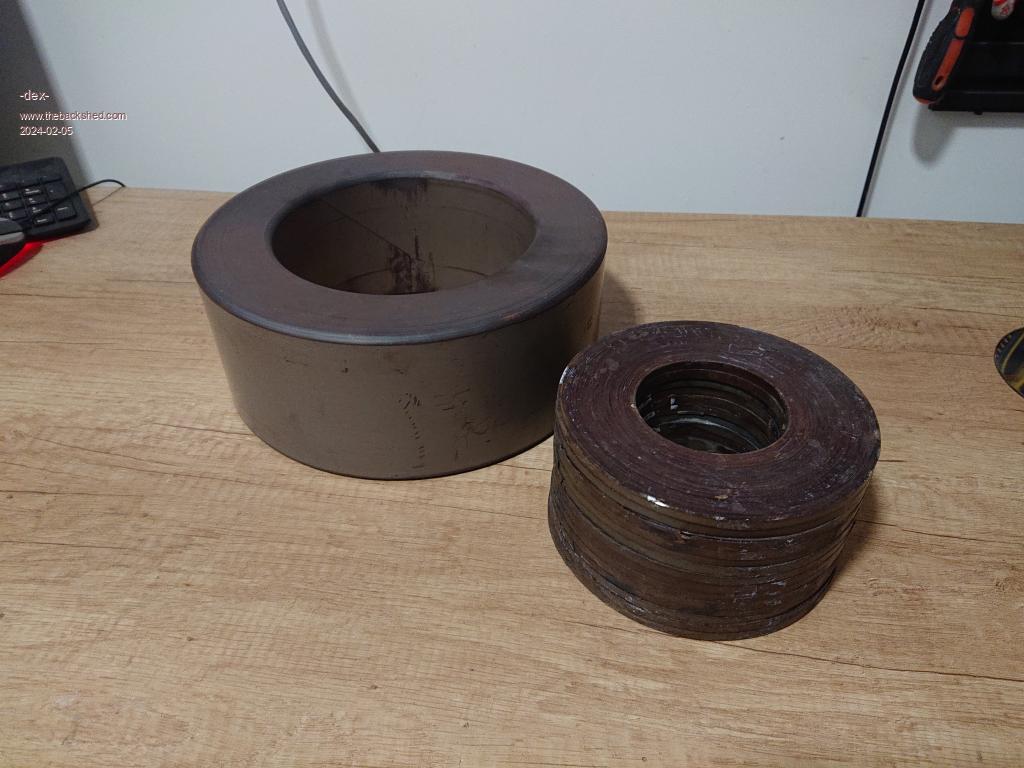

Perhaps power-wise by gluing two together I would achieve the required power, but after calculating the windings it comes out that they will not fit in the window (OD=145mm, ID=65mm, H=80m, 7kg weight) Basically it is 14 small disks glued together. I will save it for later.

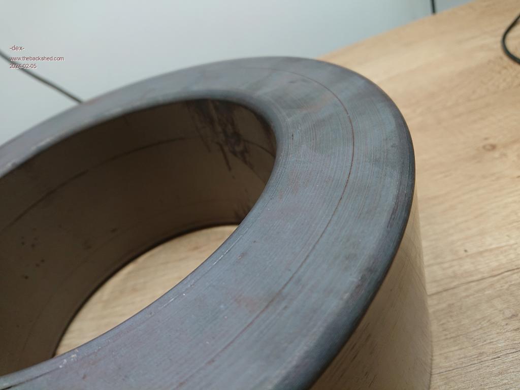

I asked a lot of companies making transformers or cores and no one wanted to talk to me, I'm just too small - this was no surprise to me. But finally one company spoke up and made an offer to inquire.

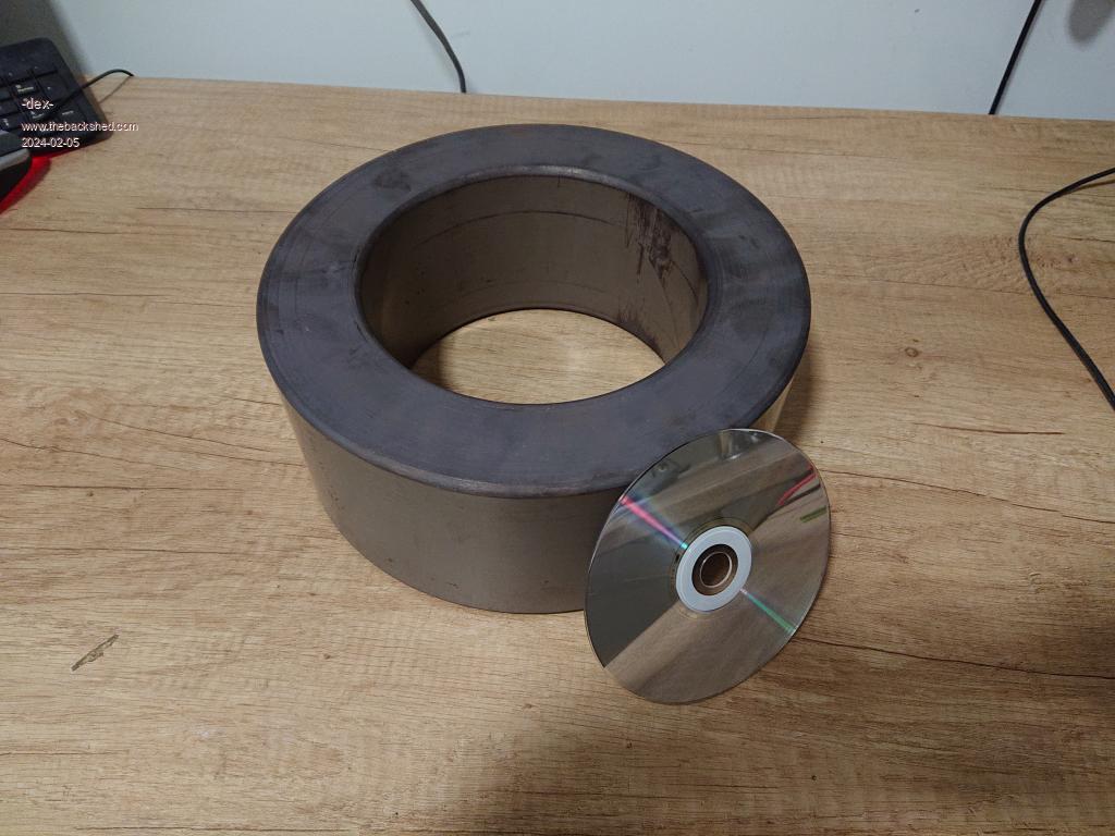

OD=250mm, ID= 160mm, H=100mm, weight 21kg. Chamfered edges, annealed steel, made of material in grade M095-23P/ETH095-23. that's it!
![](uploads/-dex-/2024-02-05_063438_IMG_20240204_192155.jpg)
With CD for size refernece

And for compare sizes two of them
![](uploads/-dex-/2024-02-05_063826_IMG_20240204_195827.jpg)
