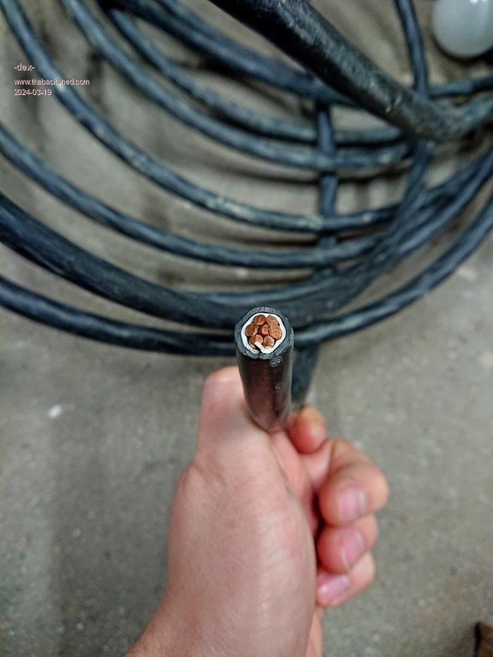

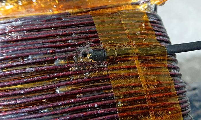

I'm finishing the transformer. I added a small NTC temperature sensor. The first mistake also happened - I accidentally ordered the wrong cable for the primary winding. There is 50mm2 with 7 x solid wire, in a double rigid halogen sheath. Stiff as hell. Then finalyy I ordered a welding cable and it installed without any effort
