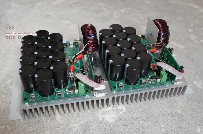

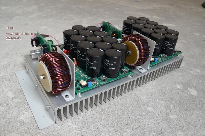

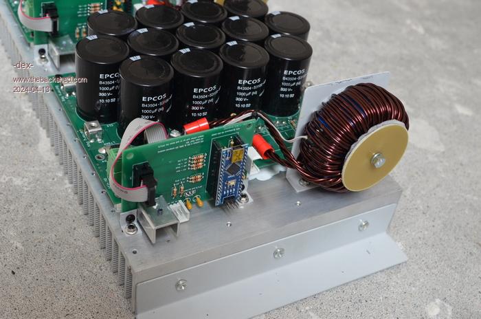

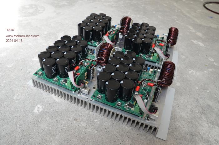

I assembled 4 MPPTs. Don't they look familiar for backshed members?
The inductors were wound with four parallel wires, the inductance is 190uH and the estimated saturation current is around 60A.
