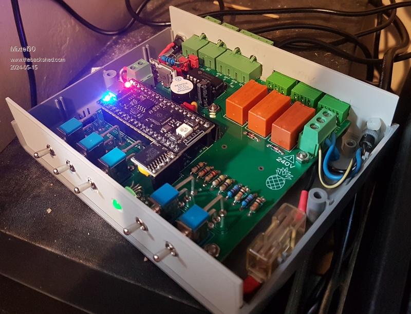

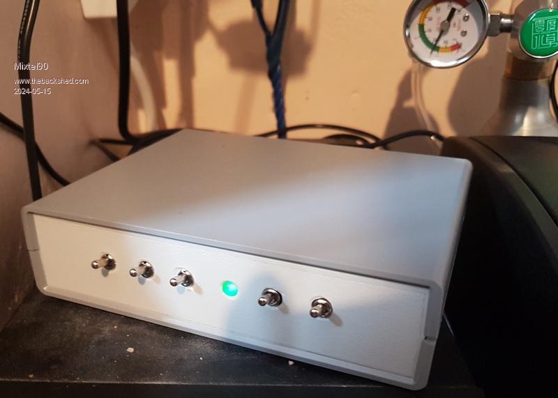

Something I should have done is to put suppression on the filter pump relay contact. The motor is small, but there is sometimes enough interference when switching it to crash the processor. I thought I might have been ok, but it appears that there is nothing built into the (encapsulated) motor.
