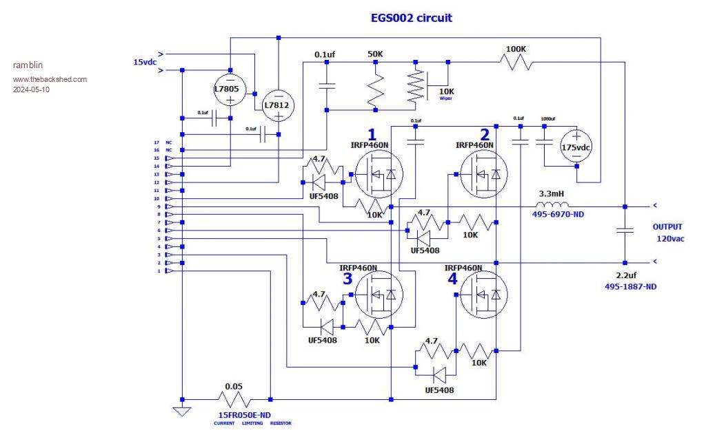

My generator/inverter project ....
Author
Message
ramblin
Joined: 26/03/2024
Location: United StatesPosts: 29
Posted: 12:48am 10 May 2024
I believe this is accurate now.
