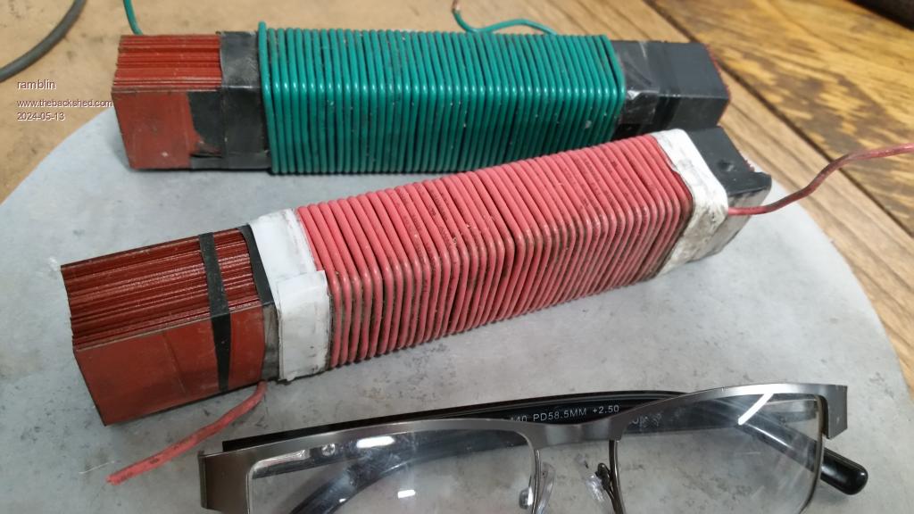

My generator/inverter project ....

I knew I messed up on the choke. With that explanation I see how bad. Most of my surplus are going to be ferrites (lots of ferrites) about the same size as pictured now. But I do have these big ones. (2) 18 ga. steel, 150 strips each, insulated on 1 side, at 1.5 lbs apiece.   And this Micrometals, T650-52 powdered iron toroid.  On a chance it could be used as is, Its wrapped 1st with 130 turns of 16 ga. solid copper, silver plated, teflon coated wire. 2nd wrap is (3) evenly spaced (120deg.) of 20 ga. solid copper, silver plated, teflon coated, 41 turns each (could be tied together) for total 123 turns.
