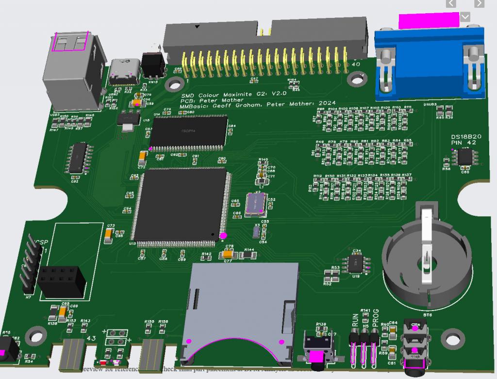

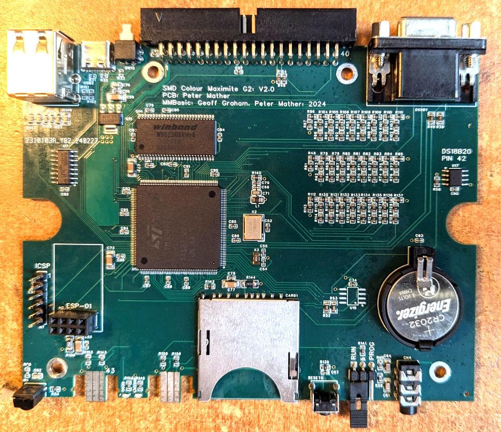

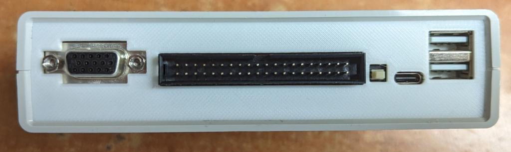

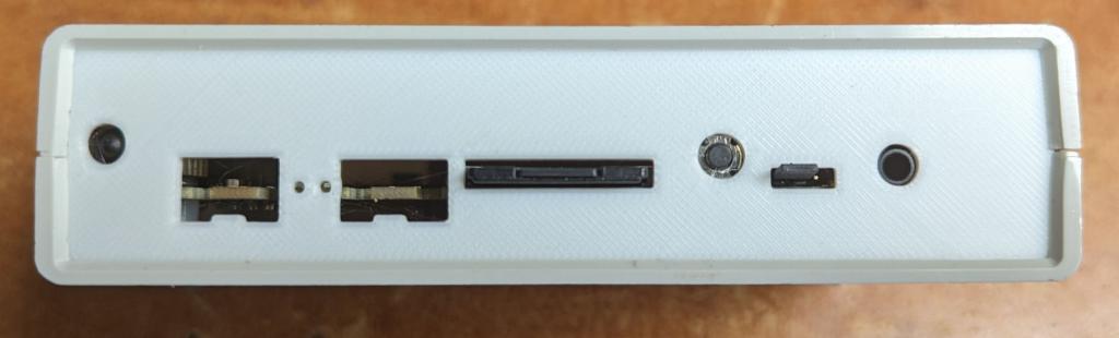

The CMM2 G2 V2 is designed to be much cheaper to manufacture than all previous designs. JLC can build it ready-to-run for about £133 for 5 boards (+, of course, shipping and any local taxes). It is functionally identical to the previous versions with the exception that it does not support the Hobbytronic USB mouse I/F chip. PS2 mice are still widely available and plug directly into the bottom USB socket (USB keyboard in the top). As before the Microsoft Basic Optical Mouse is highly recommended and both the V1.1A and V2.0 versions work well the the CMM2. I have 3 boxed CMM2 G2 available for sale (2 off G2 V2 and 1 off G1 V1.5) as I'm rather "over-stocked" for my development needs. Contact me by PM if interested ![]() ![]() ![]() Gerbers CMM2G2V2.0.zip Bill of materials and placement files CMM2G2V2.0BOM.zip Design files for box ends: Cambam, dxf, Sketchup, stl CMM2G2V2ends.zip EasyEDA design files CMM2G2V2.zip Schematic CMM2G2V2Schematic.pdf Currently all parts are in stock at JLC ![]() Edited 2024-04-04 21:52 by matherp |
